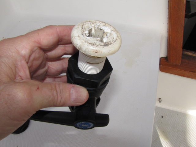

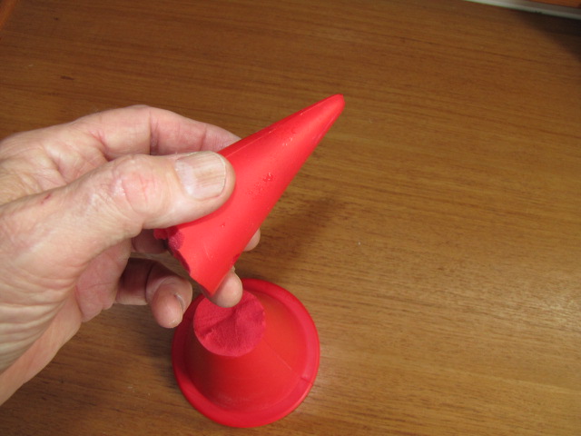

OK, the deed is done. The Forespar valve on my boat (head intake) was not repairable. I went over the side in my wet suit and found the intake hole with my girl friend helping me line up with the right spot fore and aft. Like some one said earlier, I could reach the intake on the hull without getting my face in the water, although, it was hard to locate because the outer flange is flush to the hull, faired into the gelcoat. The inner diameter of the intake is very small, maybe a half inch as I could only get my little finger in it. The small dia, made it easy to plug. I used a cut off tip of emergency foam plug, (see photo) and it held well and cut off almost all the water flow.
The rest was easy, just removing the hoses, spinning off the broken valve and screwing on the new one. A piece of string tied to the plug allowed me to pull it out without putting the wet suit back on. I worried much more than this job deserved. But better safe than sunk.
See photos, the thru-hull valve in the picture is just an example, an old one I had laying around to show the correct outer and inner diameters and how the plug fit.

Well, those are definitely not the OEM valves that were on both Catalinas we've owned. And there is no raised mounting flange donut under it either. Makes you wonder if a PO at some time changed all the OEM ones for the aftermarket version, maybe because of the horror stories you hear about the OEM ones now and then. Good that worked out so well for you though, definitely changing that would be much easier than changing an OEM one. But then again the OEM ones are easy to rebuild. Nothing is ever simple on a boat.
Thanks for sharing all that, Sam. Glad it worked out for you!
