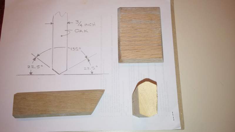

Recently I made some oak wood sanding blocks that make repair finisihing easier. I took some 3/4 inch thick oak and cut 22.5 degreee of each side, so I had a 135 degree point on the center of the edge -- the same angle as the grooves between the diamond hatch. Now, after I repair, I wrap my sanding block with wet or dry sandpaper and start in the non-repaired grooves and then go over the repair area. You can round the point at the edge of the block to make a ramp as the block enters the repair area.
For very small repairs, I no longer use the mold. I just put excess gelcoat in the repair area, and sand the proper diamond pattern back in.
I have attached a picture that may help. I hope this helps you as much as it as me.
