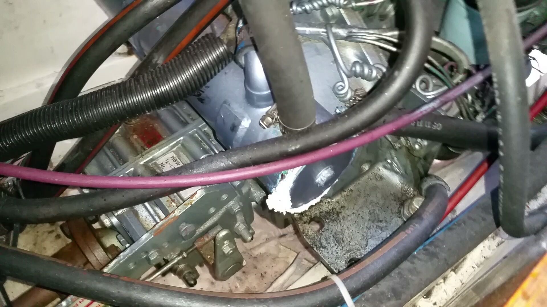

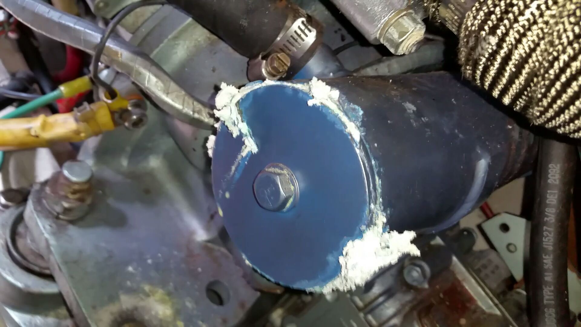

Is this salt buildup on both sides of my heat exchanger normal?
Also, when I went to wipe the salt off, a piece of what felt like protruding gasket came with it. See picures...

I don't know about "normal" but all I can say is mine never looks like that!  I usually have a little green coloured discoloration around the edges, that's about all...
Posts: 583
I would venture there is a leak right there. Some of it salt and some of it electrolysis of the metal. Looks like it should be taken apart, cleaned and if need be replace the gasket.

No, it shouldn't look like that.
The exchanger end gaskets (both ends) and their associated O-ring should be replaced on a regular basis...as you're in salt water I suggest at least annually. In salt water, you should probably check the zinc at least every three months until you get a feel for the wear rate.
A variation on the above: I almost never open the portside end cap because the zinc area is what I want to see. I open the starboard end cap top look for debris from the zinc.
You purchase the zinc with a length longer than what is proper for the exchanger. Just gently hacksaw the zinc so that it screws into the mounting hole without impinging on the exchanger core. If you put a zinc in while the end cap is removed it's easy to see what the zinc is doing. If it's too long the fragile zinc can crush - ie, crumble - and then it will be ineffective against corrosion, and the crumbled debris could take a trip around your cooling system.
When you reinstall the end cap with a new gasket and o-ring, the gasket goes directly against the exchanger body, then the o-ring goes outboard (against the end cap) of that. Putting the o-ring on the exchanger body side and then large gasket outboard will make for a poor seal.
