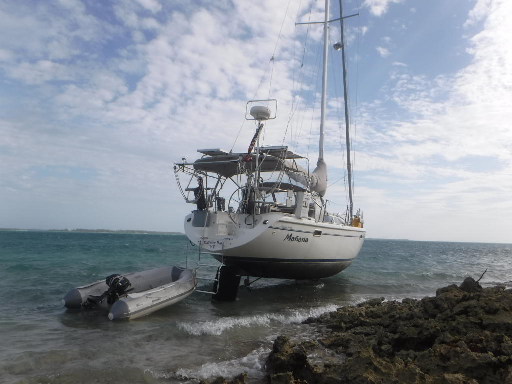

Unfortunately, this is one subject I would prefer not to be an “expert” on. I can assure you, you will pull out your bow cleat before you have a problem with your keel bolts on a Catalina 36. Now your rudder is another thing. If you are on a hard bottom you will most likely bend your rudder post when you are pulled off. I know from personal experience on our Catalina 36 MKII and from another friends experience on another Catalina 36 MKII. Also, have another friend that had the exact same problem on a Catalina 38, wing keel. Maybe, I am contagious !
Catalina may claim the rudder is shorter than the wing keel, but if it is, it is not enough to make any difference. By the way, I had no damage to the keel, but had to replace the rudder. The same results for the other two Catalina's.
http://vermontsailor.blogspot.com/2016/01/our-ocean-front-condo.html
