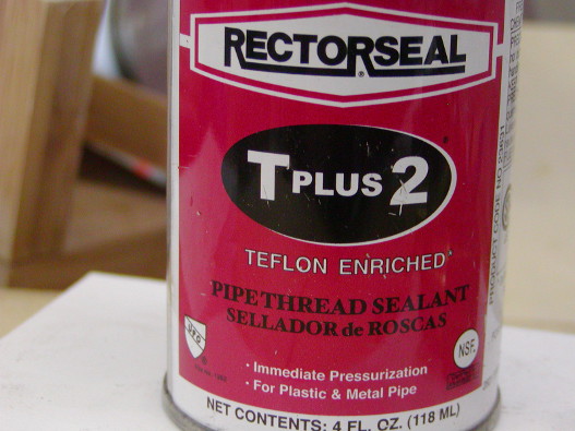

Here is what I use both on the stuffing box and the rudder cover post. It remains soft and prevents water leaks inside.
