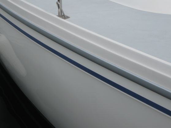

Well, I got my rubrail installed. Much less daunting than I imagined, but the bow is a bit nasty with the anchor roller in the way. Sure looks better than the nasty old tan colored one.

[QUOTE=wfahey;3116]Pictures or it never happened! ;)[/QUOTE]
Voila!
[ATTACH]165[/ATTACH]
Very nice Mike. :cool:

Looking good!! As far as bang for the buck, I think this is one of my favorite projects!
