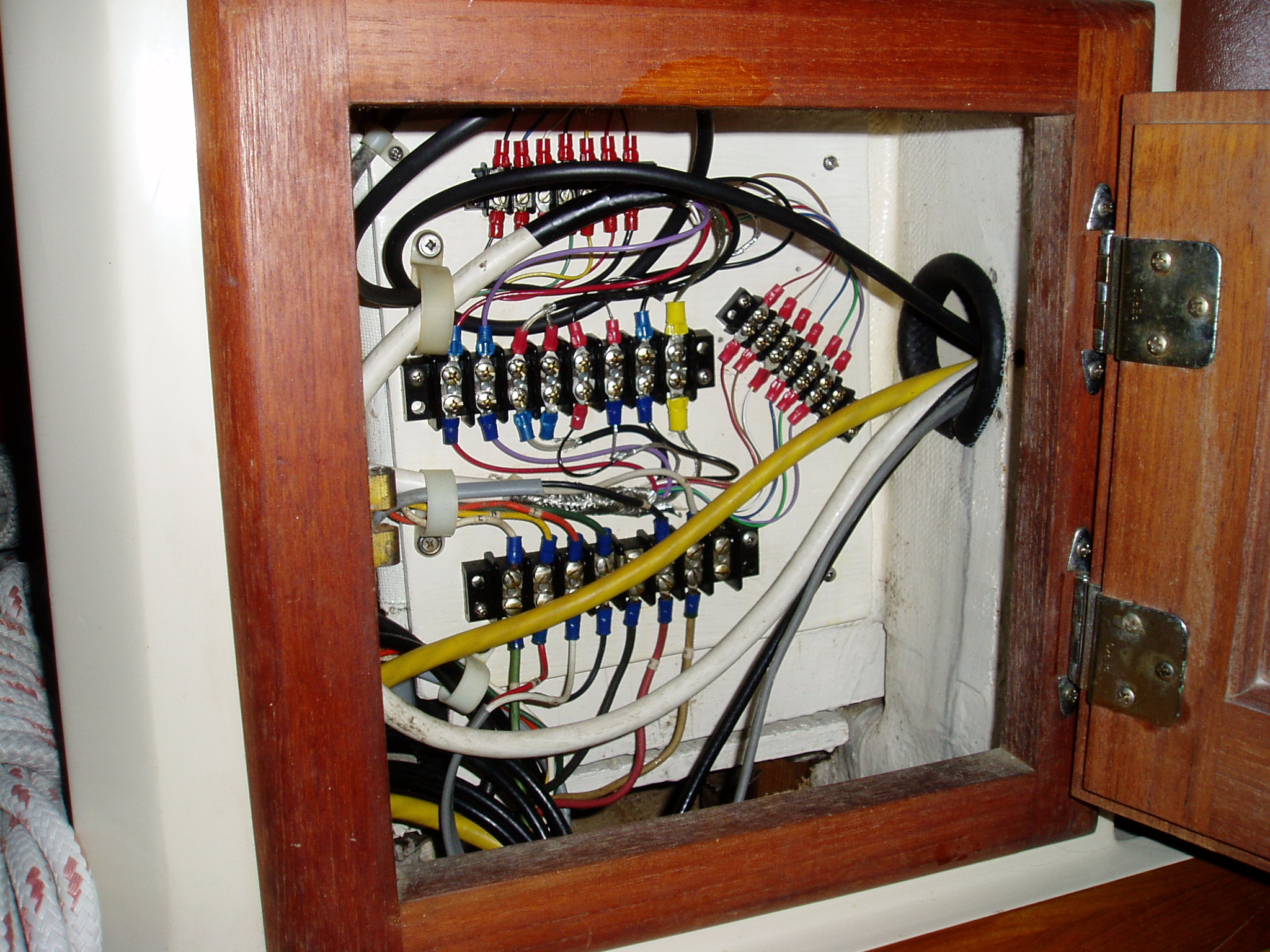

I installed radar with the mast up, but it was a standard mast, MkI, dinette interior, and I didn't run the wire in the conduit. The mast wiring exited the mast from a 1.5" hole near the  base of the mast, and all wires were attached to terminal blocks at that location.  My wind instrument wire went thru the masthead fitting in a 1/4" hole, so obviously the lower fitting was cut off. Using the current wire as a messenger would be doable if the top hole is big enough. Without a messenger I think you need to drop the mast. Sorry.
