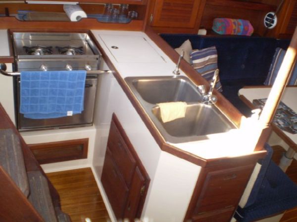

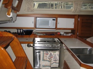

Hi Gary. No, I have the same Formica as was used on the 1990. However, as seen in the photos, in 1990 they just dropped the sink into the hole in the Formica and let it rest on top of the counter. In 1991, they dropped the sink through the hole in the LINER and let the sink rest on the liner. THEN, they put the Formica on top, sealing in the sink and not allowing it to be lifted out. What I would like to end up with is the new sink dropped in like the 1990 picture. BTW, your video was spot on, where the FG liner is the plywood and the Formica counter top is the granite (with the sink sealed in between).
1990[ATTACH]852[/ATTACH]
1991[ATTACH]853[/ATTACH]

Hi Tom. I'm afraid that's what I'll probably end up doing. The good news is that since the new sink will drop into the old opening, I won't really have to remove the remaining "lip" from the old sink, but we'll see. I just this minute sent off an email to Gerry Douglas to add his concensus to the collective wisdom. I'm anxious to hear what he thinks, since it was apparently his idea to undermount the %#$&! sink in the first place. LOL
**UPDATE** Gerry Douglas responded to my email almost immediately and suggests lifting the counter to get the sink out. He says it is only screwed in from below with a little silicone which is easily dealt with. He also forwarded the issue to Kent in Engineering who kindly emailed me the contact info for a Catalina worker who does work on the side who he thinks could get it done. I'm very pleased with the response from both of them given it's a 21 year old boat! Just another reason to love my Catalina 36.
Mike,
Thanks for the picture it was worth a thousand words as they say. Your best bet is to go the way you are thinking and just follow the contour around the lip of the counter. The metal is not all that heavy albeit SS A good dremel tool or air tool as suggested would be what I would choose. Perhaps build a box frame around the sink with the front open for access or tape plastic around would keep the debris from flying all around the boat.
Good luck and I'm glad I only have to pop mine out when it comes time to replace. It is on my list for the future.
