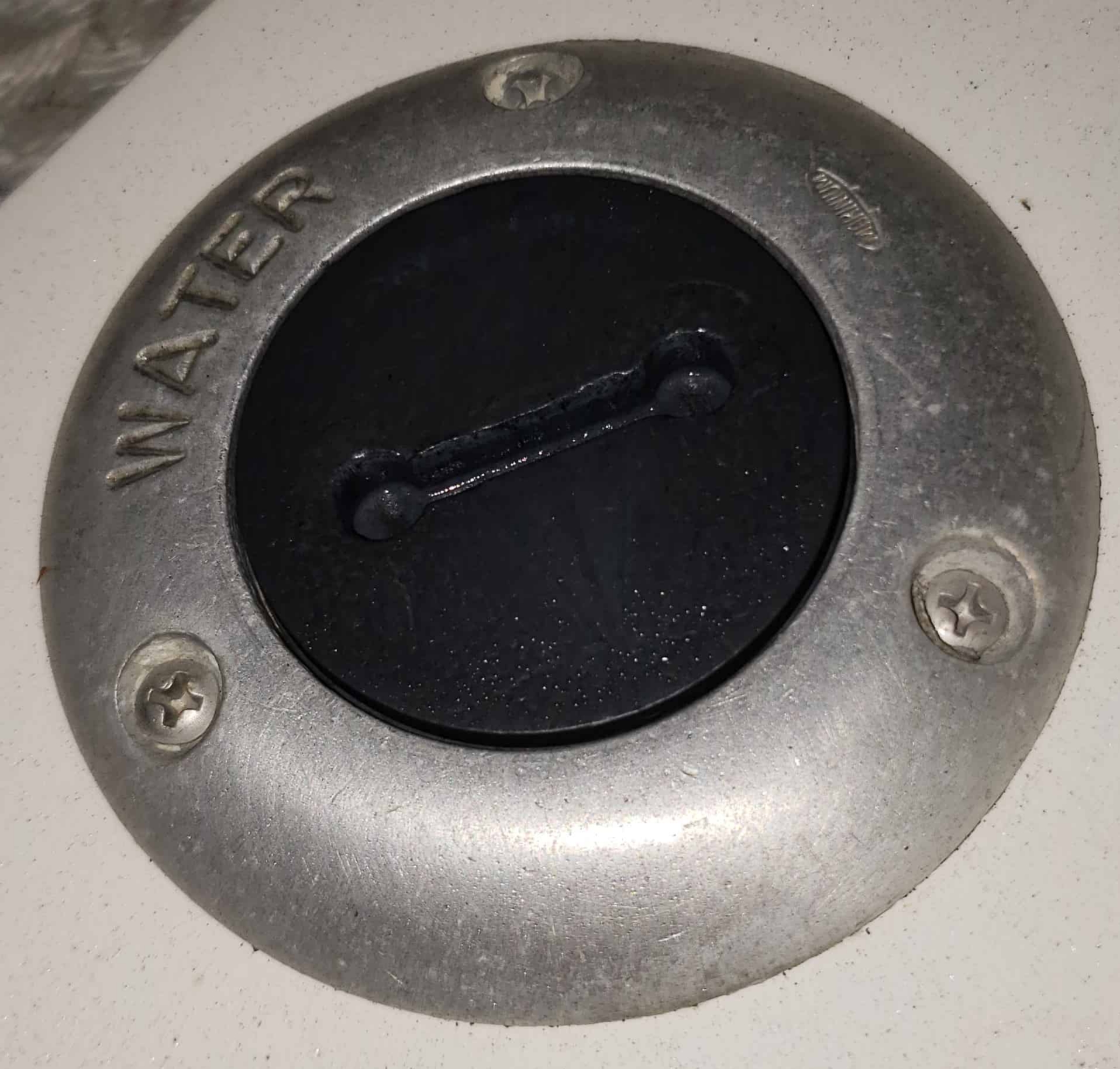

Where can I get replacement deck fill caps?
My caps are all black plastic with dog bone spanner wrench holes. See pic.
I bought a 1-1/2" Sea-Dog cap, but it's too small. The Sea-Dog threads measure ~1-1/2" diameter, while the threads on the old cap measure ~1-3/4". Catalina Direct sell 1.5" caps, which I presume would, like the Sea-Dog caps, be too small.
But I can't find any 1.75" caps on the Internet.
Thoughts?

I got mines, some years ago, from www.go2marine.com

Joe -
According to the description on Catalina Direct's site for this item (https://www.catalinadirect.com/index.cfm/product/4150/deck-pipe-cap-diesel-stainless-steel.cfm) "Threaded portions of cap that threads into pipe is 1-13/16" OD, overall width is 3-3/8" OD." Sounds close to your ~1-3/4" descrption.  Have you called them to check on this?
