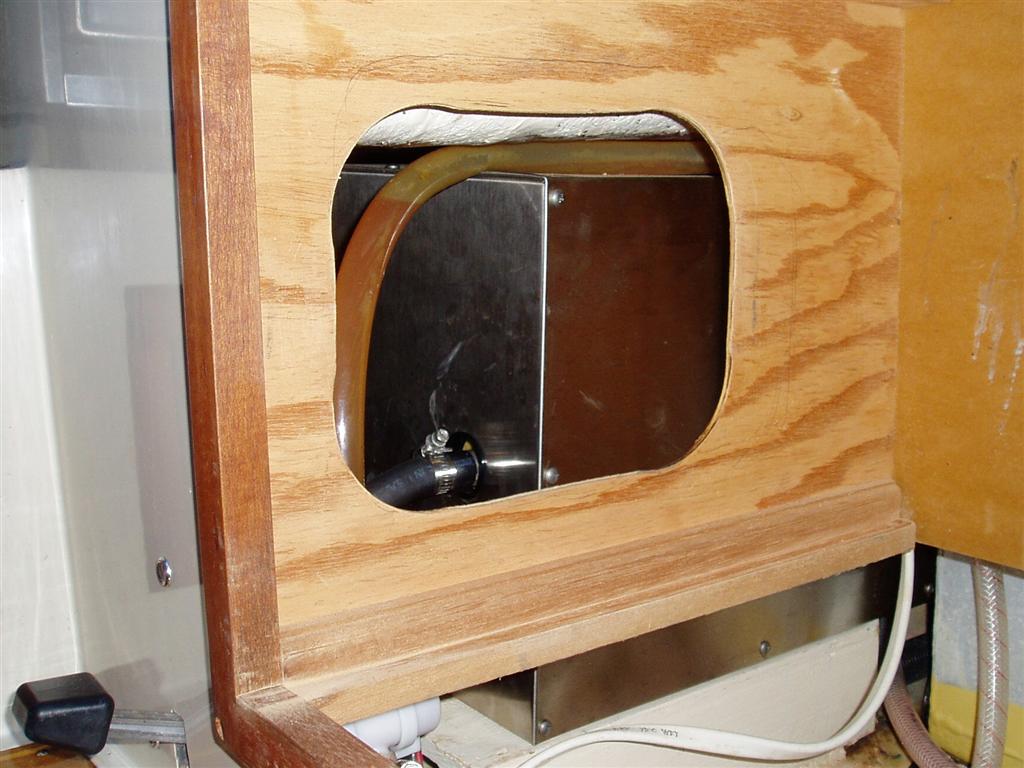

Bud and jtrigg,
Another thing you can easily do is to cut a hole in the outboard side of the drawer assembly. This gains you access to the aft end of the W/H for inspections, tightening clamps, etc. Just takes a few minutes and does not alter the structural integrity of the drawer assembly. It also helps with the access to the foot pump, if you have one in that area.
Tom, did you notice any extra speed from the boat after removing the weight of that plywood? :)
+ 2.754 knots. That was the primary reason I did it..... ;)
