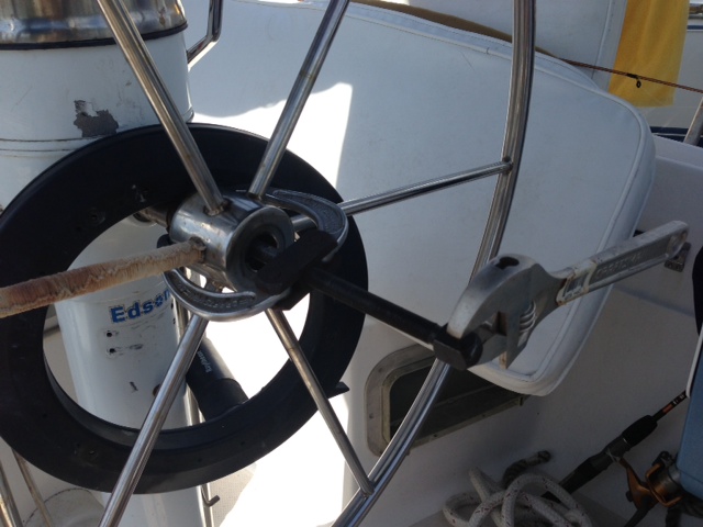

Bought a new belt for my Autohelm ST4000. I need to remove the wheel of course to get the autopilot off.
Unscrewed the big wheel nut, and it came off very easily. But big shock, the wheel seems to be frozen to the axle. Made a makeshift "gear puller" out of a prop puller, but even with intense pressure the wheel didn't budge off that axle.
Been soaking and tapping with PB Blaster all day, but still won't budge. There's no sign of corrosion. Started to think I was doing something wrong, but as best I can tell, the wheel should slide right off the axle (like every other boat I've owned). Key seems to be in its slot from what I can tell peering into the keyhole.
Next step is to borrow an actual gear puller and put a few tons of pressure on it.
Has anyone run into this issue?

Heynewt... I had the same problem the first time I took of my wheel.... had to keep putting blaster on it and tapping from the back. A prop puller might work but whatever you do be careful not to damage the threads.
Blair... I have the wheel auto helm and I find I have to secure the inner ring with wire-ties when I take it off. Hence I don't remove it except during the winter.
Randy... is anyone wearing it when you fix your wheel to the "bikini"? Sounds like it would be uncomfortable to be dragging the wheel around.
I keep a 3 arm gear puller on board to remove mine. The wheel axle is well greased, but still very difficult to get off.

Ahh, ok, good to know. I can't believe how hard this was to get off. I've pulled flywheels off rusted motors that took less effort. Greased it up really well when I put it back on.
