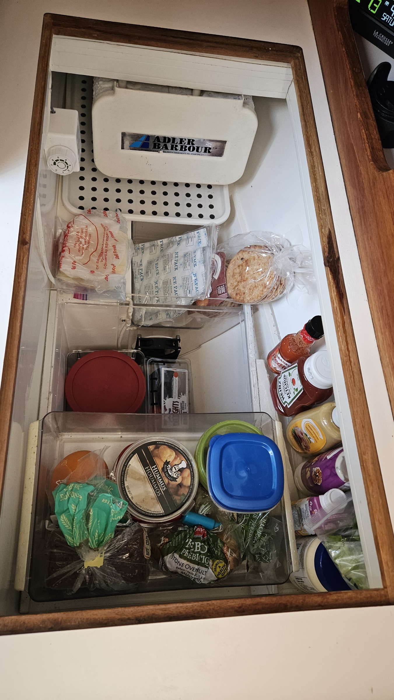

They're heavy! No water-filling, just 40 year old technology. You could probably remove the plastic forms, empty what's inside and refill with expanding foam to reduce the weight. Still, most of the weight is likely the plywood and arboretum. I'm pretty sure that the depth of the plastic forms is overkill insulation wise.
Posts: 259
After replacing the original unit with A nova cool, I did some fiddling and crafted an acrylic sliding drawer with a box on top that gave us much more access to the bottom of the fridge. Also added the computer fan the bottom. Much more efficient use of electricity than the original and the freezer box stays Frozen with some monitoring of the external temperature units and the thermostat.
Army Sailor
Joined: 11/2/23
Posts: 62
Nice setup.  I noticed you said you replaced with a nova cool but the evaporator lid still says adler barbor.  Did you adapt the evaporator lid to the nova cool evaporator or did you use the original evaporator with a nova cool compressor unit.  I replaced the whole thing with nova cool and my old evaporator lid doesn't fit it.  I wasn't able to find an evaporator lid from nova cool.
