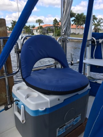

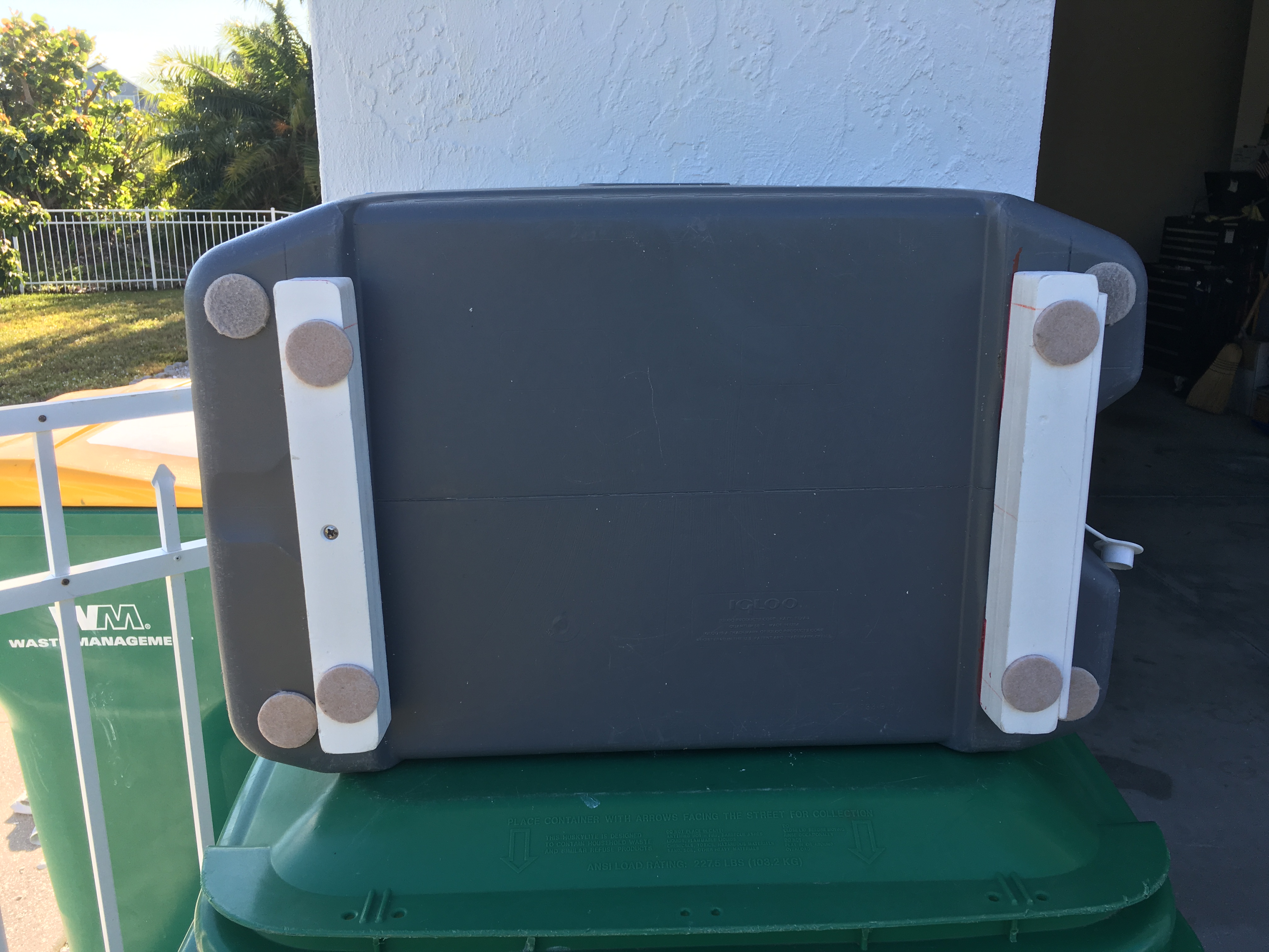

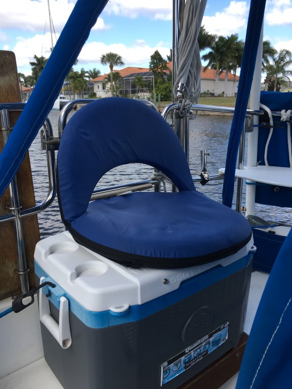

With drinks in the cockpit; I use a Igloo 52 qt. cooler seat contraption that I made. It gives me a helm seat and an ice filled cooler at the same time. Works out very good since I don't have too go far for an adult beverage. I added some plastic side supports to prevent side slippage and a cushion for the top. I'm thinking of lining the think with additional pieces of foam insulation.
