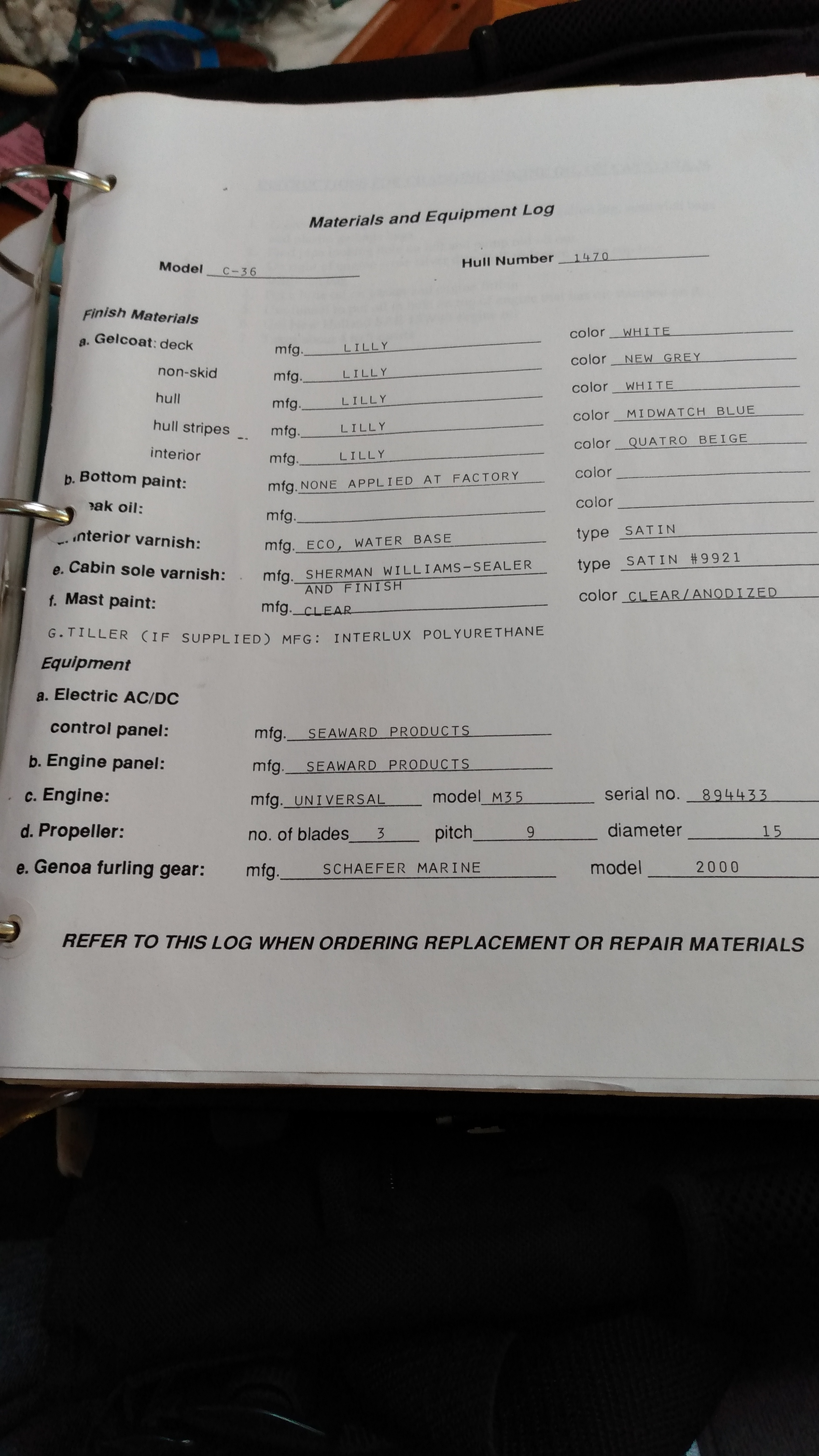

We got satin, the Target distributor told us that was what Catalina used for everything inside the cabin. Comparing old finised areas to newly refinished areas, it seems right. I agree with Pat T about the oil based for outside, I use gloss Bristol or Cetol clear gloss, prefer Bristol but it is ridiculous costly now. And both of them do darken teak a lot, the interior looks way better with the lighter water based finish IMHO.
Here's what we've learned
[url]http://c34.org/bbs/index.php/topic,2348.0.html[/url]
[url]http://c34.org/bbs/index.php/topic,897.0.html[/url]
Also be aware that West Marine makes a combo teak cleaner and brightener in one bottle which may save a step on work down below. I used it on our handrails and it works just fine.
Target no longer makes the Oxford series of coatings. Here's the link to what I was told is the current stuff that will work over top of the original finish and what I used inside without issue:
[url]http://www.targetcoatings.com/emtech-2000.html[/url]
Note that it both interior/exterior but I haven't tried it outside the cabin.
I'd be interested in knowing if anyone has used the new product from Target Coatings in the prior post. I'd love to be able to use a water based product that will stand up to some water (leaks). I can't tolerate solvent based stuff, gives me migraines. Just walking by someone using Cetol in the marina is an instant migraine. Last winter I brought home all of the cabinet doors, head door, ladder and the trim above/below the windows/ports. I stripped them all and used Helmsman varnish, applying it in my wood shop wearing a respirator. May have given some mice a headache, but left me alone. All are darker than they were from the factory, except the head door, which I did not strip, just gave a good light sanding.
I'd like to put a coat or two on all of the bulkheads, just for insurance. None have any finish failures at this point, but that's probably just luck. If I could use a water based finish, that would be just great, as I could stay on the boat and do multiple coats in a weekend.
So very curious to hear if this newer product is better than the old. The product description says it's for interior or exterior, so sounds promising.
Gary, our starboard bulkhead chainplate had been leaking for some time, the leak was on the back side of it so it wasn't apparent. There was rotten wood at the bottom of the bulkhead but the finish was sound under the chainplate even though the water was running down between the chainplate and bulkhead. There was no sign of a leak at all, only when the seat back and cushion were removed and some poking with a sharp object done was there any visible signs of water intrusion, It was on the bulkhead at the very bottom where the water would pool on the fiberglass lip and soak the wood.
Our boat build sheet said the interior finish was Target water based so I called them. I was told that the original Target product Catalina used was called Embrevar (SP?) and the EM2000 is the newest direct replacement for it. Both are water based but the EM2000 is newer techology. If the Embrevar held up to that water, I'm sure the EM2000 will be fine. I've put a couple of coats on most of the interior in the cabin, including all the woodwork around the galley and any water that's gotten on it, especially around the counter and sink, has not caused any issues.
That is a big downside of this chainplate design and it's something that an owner should keep an eye on. Pretty easy to check and a lot of trouble if it's not caught early. But that's another thread.

I have been trading notes with Catalina about my MK1. Here's the response on the interior finish of my 1986... Hope it is helpful.
    "Tim
    Yes, we do know what the interior finish was on your 1986 C-36.  As you may know or guess it would      have been different in ’96 & ’06, but in ’86 the interior teak eft the Woodland Hills plant with  a very          light coat of teak oil.  It was light (as opposed to heavy) so that in a month or two the dealer (if a              stock boat) or new owner (if just bought) could either keep going with an oiled interior (heavier) or          switch to a regular (at that time no doubt oil based) varnish (such as Interlux 60).  So unlike the later      boats in the 90;s that came with a Water based varnish like Target or Nano-Sheen by Alt. Finishes,        it’s whatever was put on after it left.
     Best, Warren
      Ps:  remember, on the solid teak fiddles or grab rails, you can sand away, but on the veneered              bulkheads, don’t sand much on the 1/16” veneer or you’ll go thru!"
