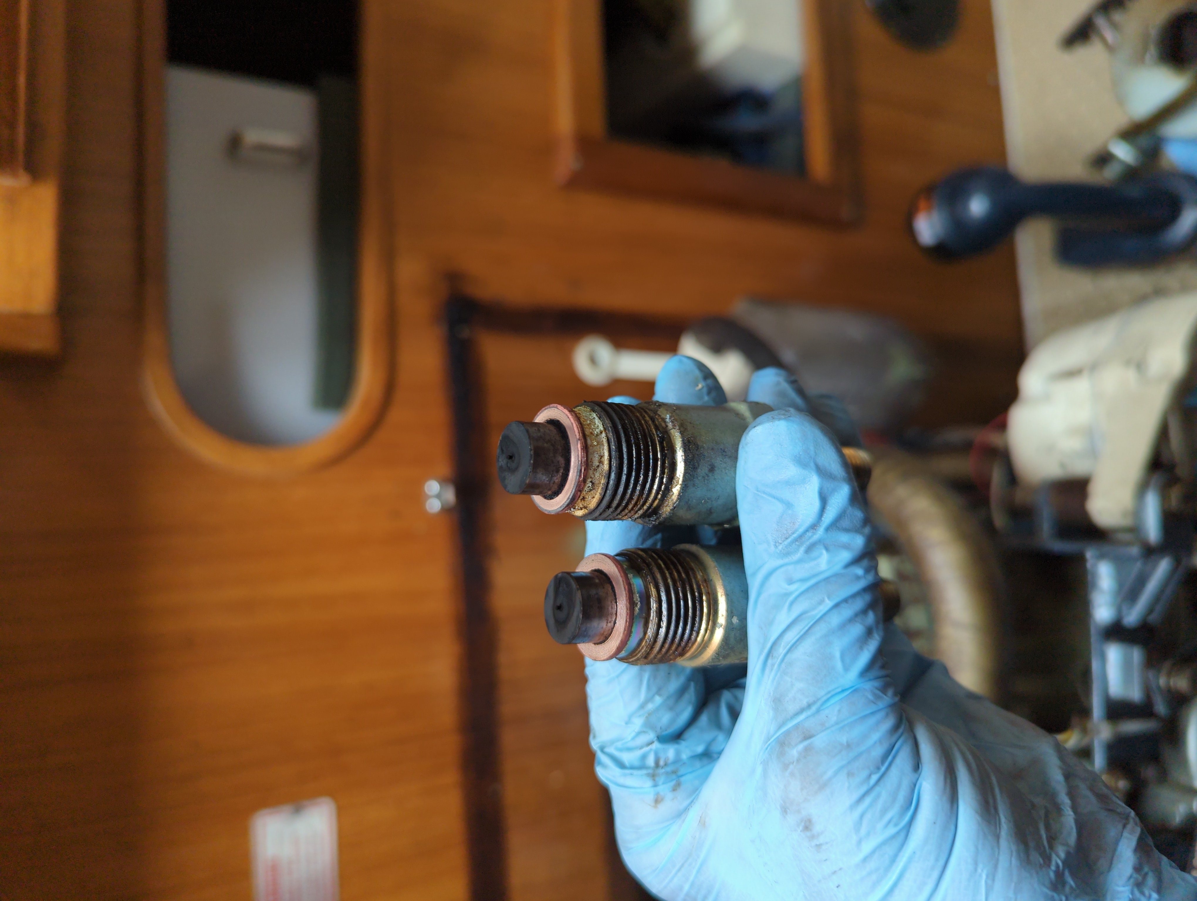

This pic is rearmost (#4?) Injector.  Not sure what a 1760-hour diesel injector is supposed to look like.  Is this 'normal'?
Have three new injectors and will install all of them plus best one of my existing injectors.  Fourth new injector is on order.

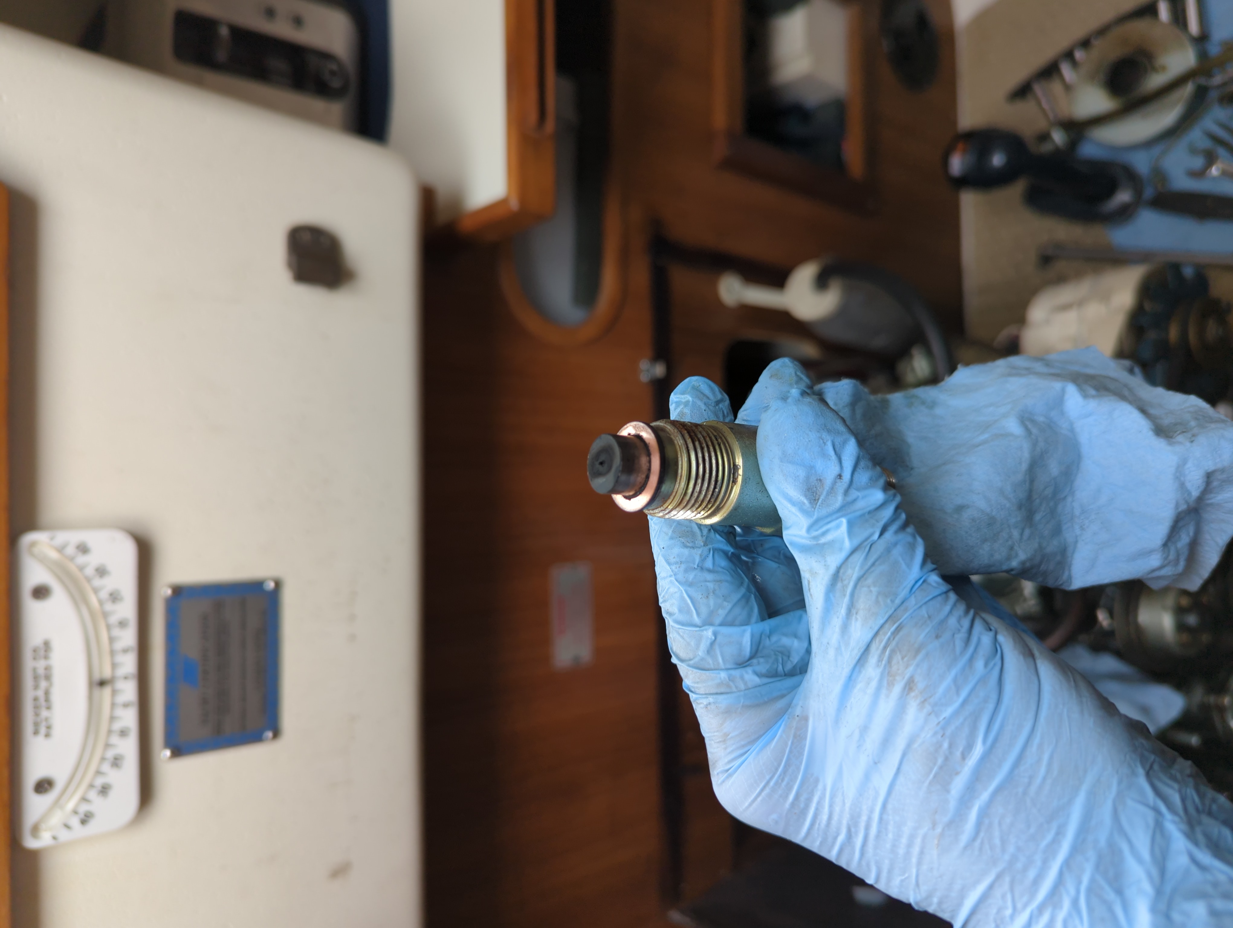

And here to the left is the number two injector and on the right is the number one injector on the belt side of the engine. The corrosion around the base of the injector seems unusual and has me concerned. The number three injector not pictured has some oil around the base but the same pattern of late carbon deposit at the tip. So I am confused...
