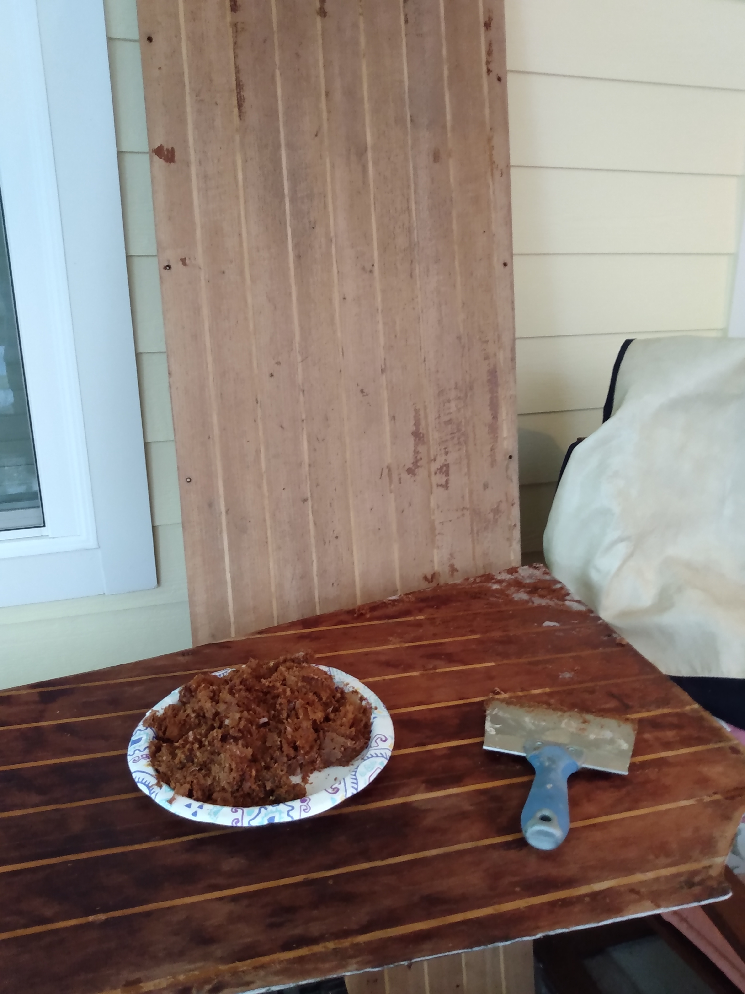

I am just starting this project. All pieces are out of the boat and using a stripper they are ready for light sanding and then finish. So afar has been a nice project. I used that citrus stripper stuff and found it worked pretty well. Then after washing I used WM teak cleaner and brightener. The use of cleaner and brightener BEFORE sanding has always been my practice. So right now the pieces are all bare and back to original T&H look. Not to the finishing step which I anticipate will go well as the finish comes on.
Another ​helpful tip I have learned is to scrape the stripper dregs off using a sheetrock knife. It has a nice scraping effect which removes everything without gouging the wood. In the pictures you can see the knife and also a fully stripped, cleaned, and brightened floorboard in the background. All that is needed now is a light sanding and urethane...
