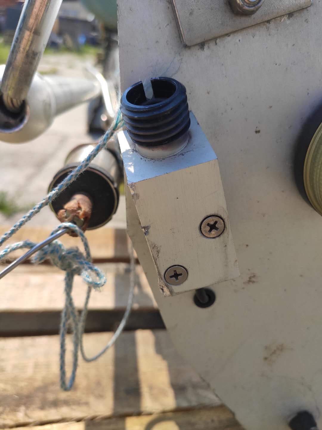

On my masthead there is (what I assume) ​transducer connected to the Raymarine ST60 Wind unit.

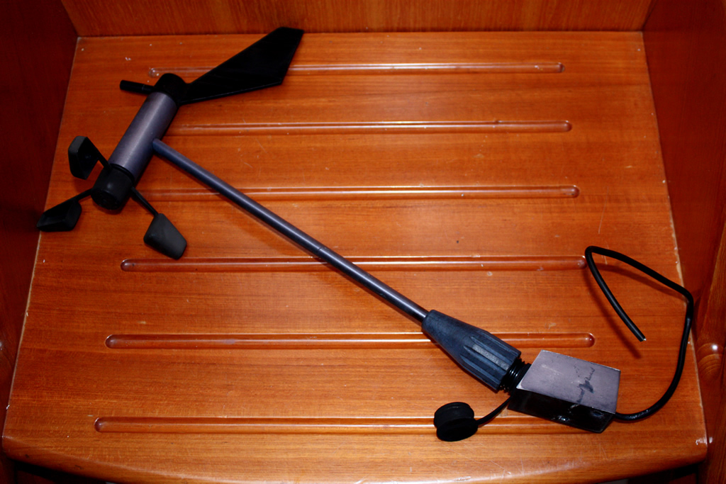

Do I need to look for the older model of wind vane:

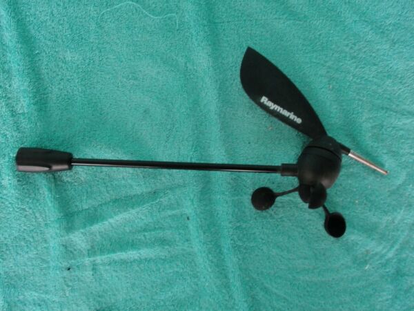

or the newer model will also be compatible

In 2015, my ST60 failed- both masthead and and pedestal units. I wanted to direct replacements but could not locate any. I went with a Raymarine R28170 short arm vane ($319 price from Defender in 2015) and a Raymarine STi50/i60 pedestal unit ($389 West Marine 2015 price). Connector and electronic compatibility was fine. Maybe this helps.
Posts: 469
Kamil, from the photos you are showing, I had the same old unit and replaced it with the new unit that you are showing. They work OK. You must turn off the power when you change the unit and must synchronize it by going out on the water and pointing North, South, East and West and making sure that it follows these directions.
