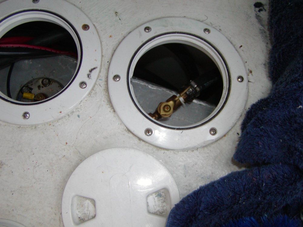

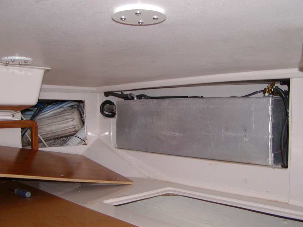

Posts: 462
Here are the images of the fuel valve that is accessible from the port lazarette . Under the other cover is the sender unit. I have also included the fuel tank itself. The valve is on the very right upper side.
 Since removing the filter was not possible by hand only and I could not insert the rubber strap filter removal tool behind the filter - I placed a 1/4" starboard spacer to move the filter attachment away so that the rubber strap would easily fit behind the filter.

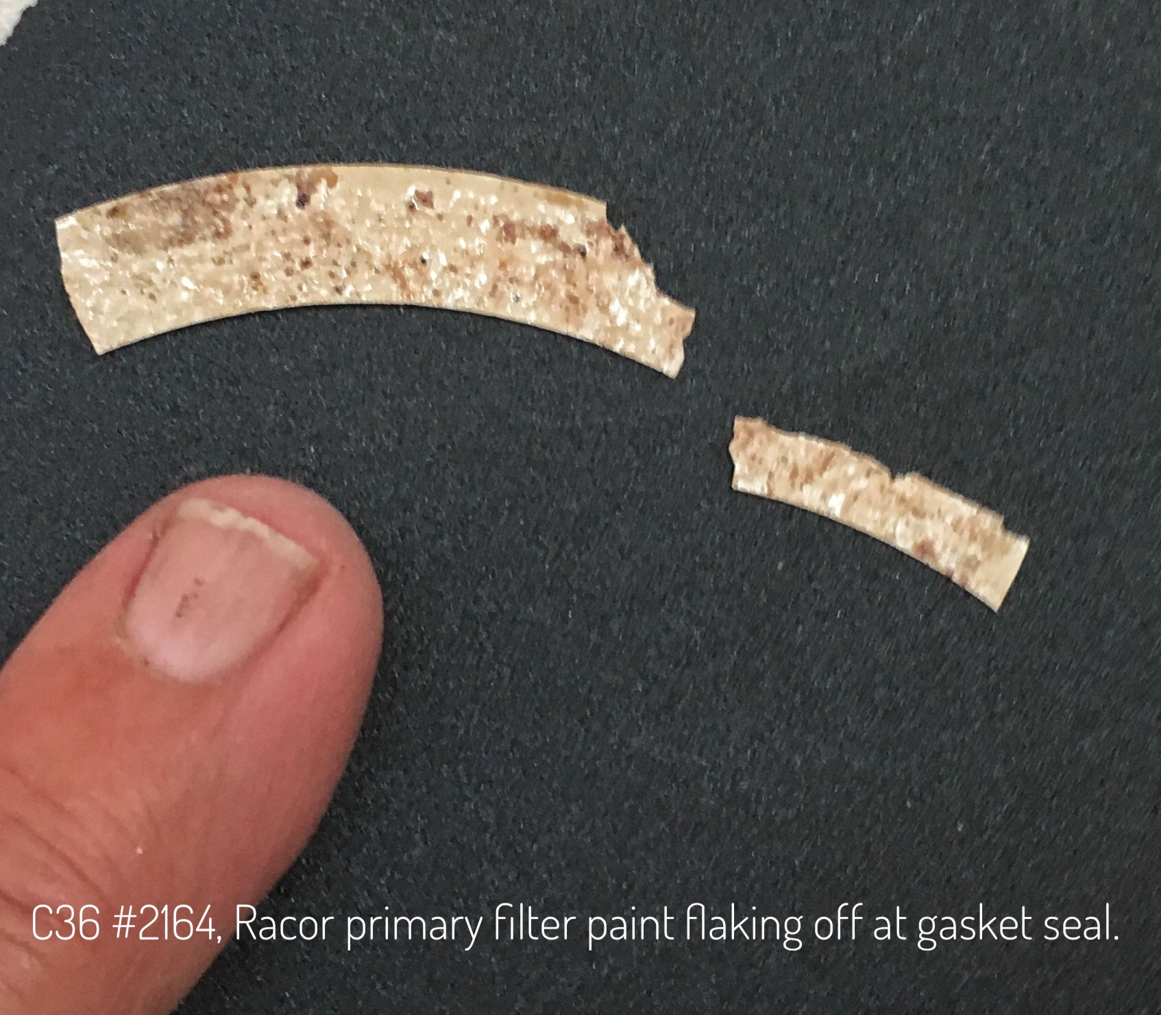

Stevenjones's picture
Stevenjones
Joined: 6/29/07
Dave,  thanks for your posting!  It helped me identify the same type of slow Diesel fuel leak in my C36 #2164 (2003 year). My Racor filter’s paint also had delaminated from the gasket surface!  Sanded the surface, installed a new filter. Your post really helped me ID my leak.  Here’s a photo of the paint pieces flaked off from the filter’s gasket surface.
