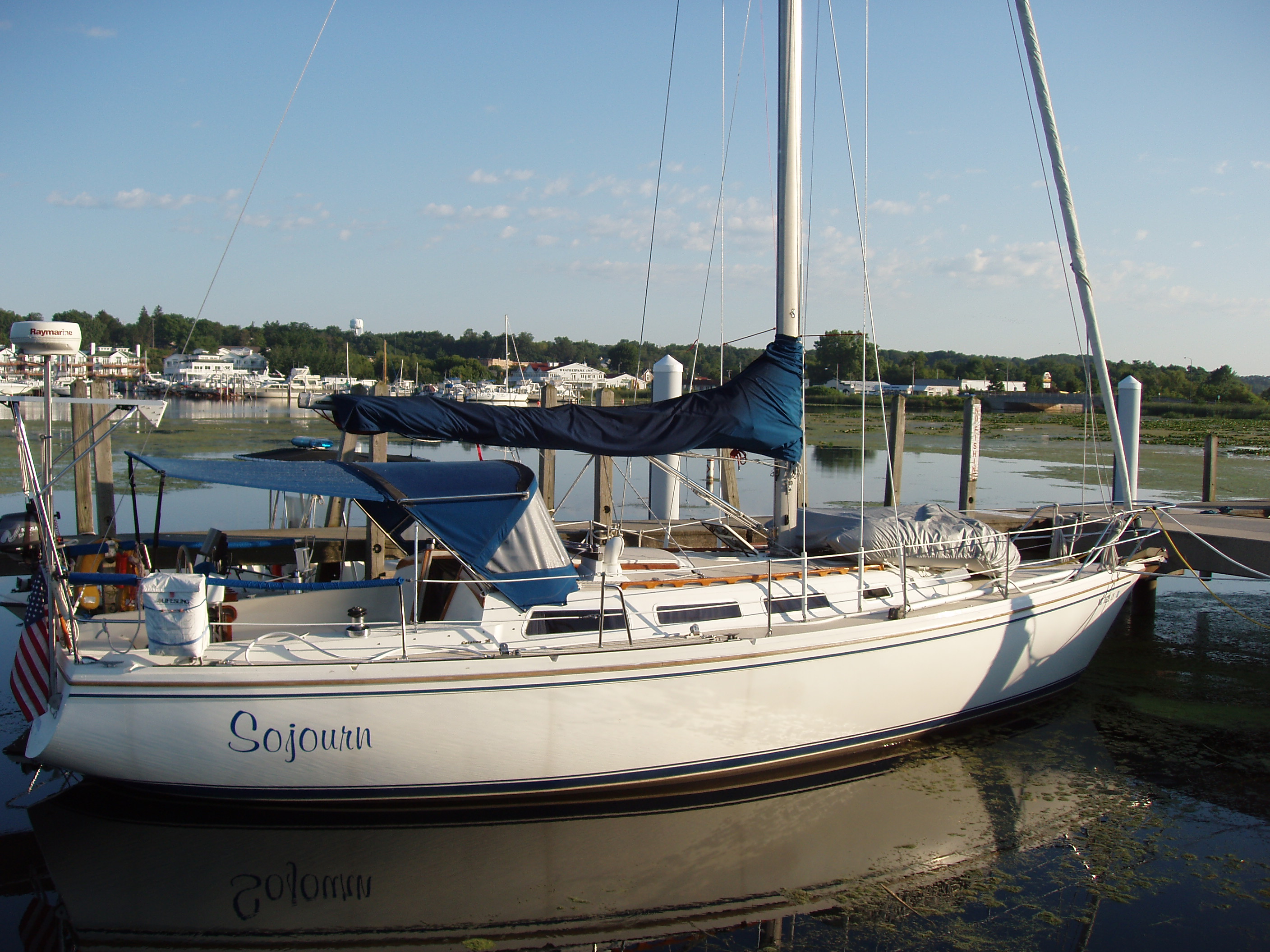

Attached is my lettering and a photo of the boat to give you a sense of size.
The hailing port is not shown as it is on the transom.
