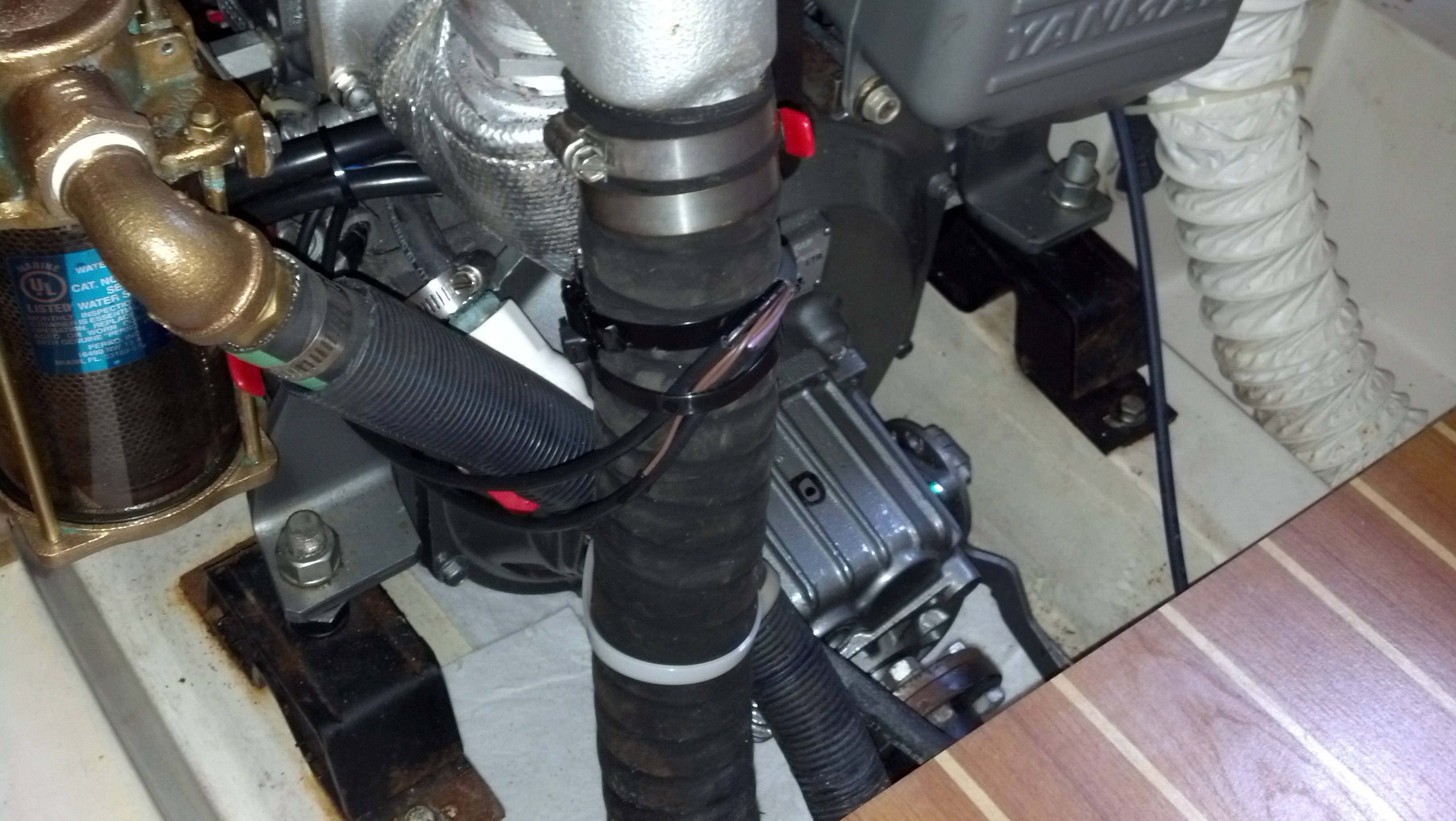

Mitch,
I think a much easier solution is a high temp alarm which senses temps on the exhaust hose, just after the riser.  I bought one from Borel Mfg for about $60.
http://www.borelmfg.com/products_alarm.htm
I didn't want the whole display and alarm, as the sensor can easily be wired into the existing temp alarm.  It's designed to go off well before an overheating problem. You have to call the factory to order just the sensor.  The website shows only the complete systems. Hope this helps.
