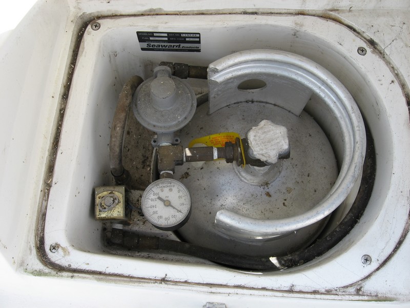

Then this was not well installed. Look at the attached picture, there's at least a foot of rubber in there between the tank and solenoid. That gives me zero confidence. That's what the locker looked like before we bought the boat. Plugged drain vent as well. None of this commented on by the surveyor. Safer than a rail mount and no solenoid? Not in my mind.

[QUOTE=bstreet;7056]Then this was not well installed. Look at the attached picture, there's at least a foot of rubber in there between the tank and solenoid. That gives me zero confidence. That's what the locker looked like before we bought the boat. Plugged drain vent as well. None of this commented on by the surveyor. Safer than a rail mount and no solenoid? Not in my mind.

As an ABYC member you would not catch me installing ANY hose between the regulator and the solenoid but this is my own perosnal preference and I often go above and beyond the ABYC standards.
That set up meets meets the ABYC standard, because it is all in the locker. I ideally disagree with that type of installation and won't personally do it but builders can because it is inside the locker.. That could be piped to fit it with the solenoid hard piped and I have done it in more cramped lockers than that.
