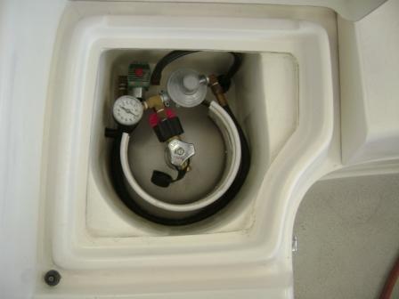

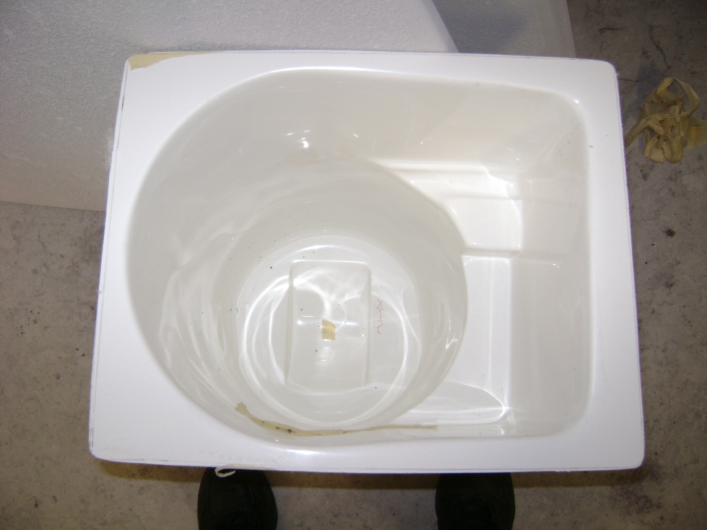

J_Handley's picture
J_Handley
Joined: 7/6/08
Posts: 8
I've purchased a propane locker "insert" from Catalina that I think is the same route taken on "Mutualfun." Catalina sent me pictures and assurances that this universal size would fit- I'll document my progress and share it all on line here.

Randy,
I have hopefully attached pics of the locker as received and as installed in a C-309. My question to you is around the flange modifications you mention. Did you lower your new locker in from the top and then cut down the flange on the boat to accomodate the extra thickness?
As you can see, the C309 install is made to glass in from below. That won't work for me since the underside of the seat locker flanges are not flat.
I can imangine several ways to get his done but am curious about the route you took.
If these pictures don't attach properly, I can email them separately or get instruction on attachments.

Jim:
I took a few pictures for you so email me, I got the same mold as you have in the picture, I will send you a detailed write up of what I had to do to install it. It works well but I presume your skilled at doing such work, It just takes times and patience.
One thing you will need to do is to lengthen the tube hole that the tank sets into, as the tank will hit the seat hatch if you do not and it will not close. There is plenty of room to do it. I have yet to seal (glass it in) the unit in as it is very handy for extra storage and access to the autopilot.
As for the drain hose, That I did not hook up as there is no hole in the bottom of the mold when you got it, So if you ever had a propane leak, there is know way for it to get into the boat. It has to come out the top.
