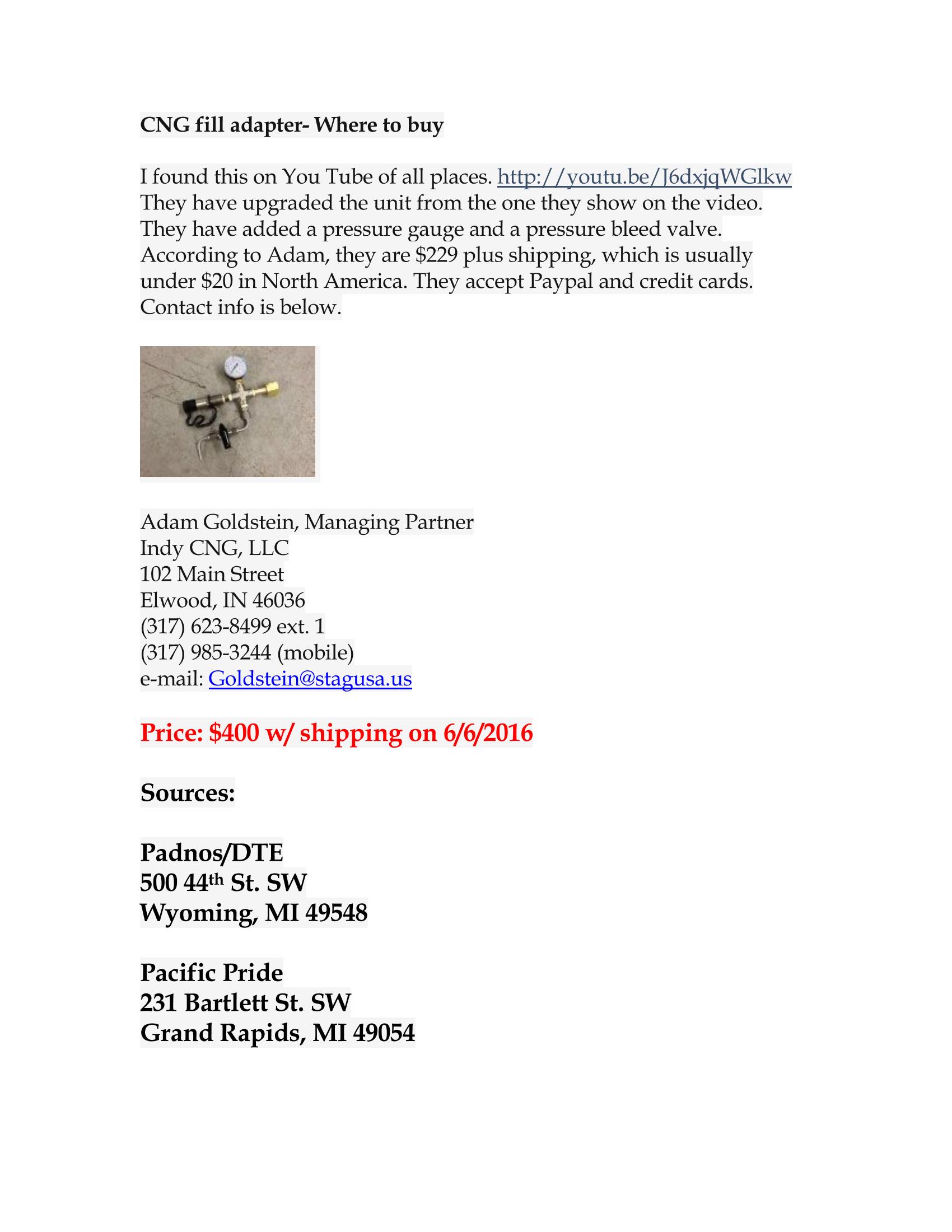

I was faced with same dilemma.  My 1985 stove manufacturer is no longer in business.  To redo the stove, plumbing and storage was going to several thousands of dollars.  My solution was to buy an adapter for filling the tank at a CNG gas station.  I live in Michigan and was able to find a reliable site.  The average cost of a fill up is under $2.00 per tank.  I have two tanks, I purechsed a second tank in 2008.  We normally cruise for about 6 or 7 weeks on the Great Lakes. We CNG for both the galley stove and grill.  I typically go through 1-1/2 tanks a season.  The tanks themselves require a hydrostatc test every 5 yrs.  Last season I had it done through a local suba shop who outsources the work.  The cost was $48 or $9.60/season per tank.  The rig was expensive $400 in 2016.  However, I have paid north of $70 per tank.  Since 2016 I have paid less than $110 for the fill ups and Hydrostatic testing.  When CNG was readily available, $35 dollars a tank was the norm, roughly $50 per year.  I'll have a few more years to break even on the sunk cost, but the replacement cost was avoided.  In my mind a big win.
By the way my wife feels much safer with cng than propane.  CNG leaks up.
I'm attaching a file that id's the seller of the rig.  Hope this hepls.
