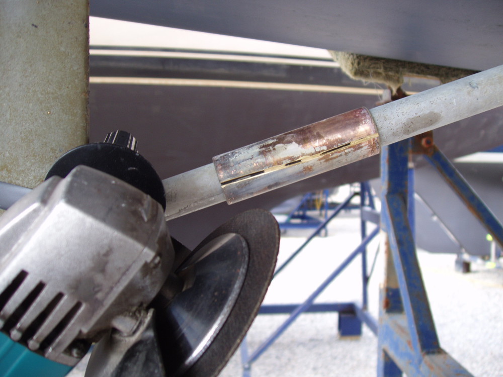

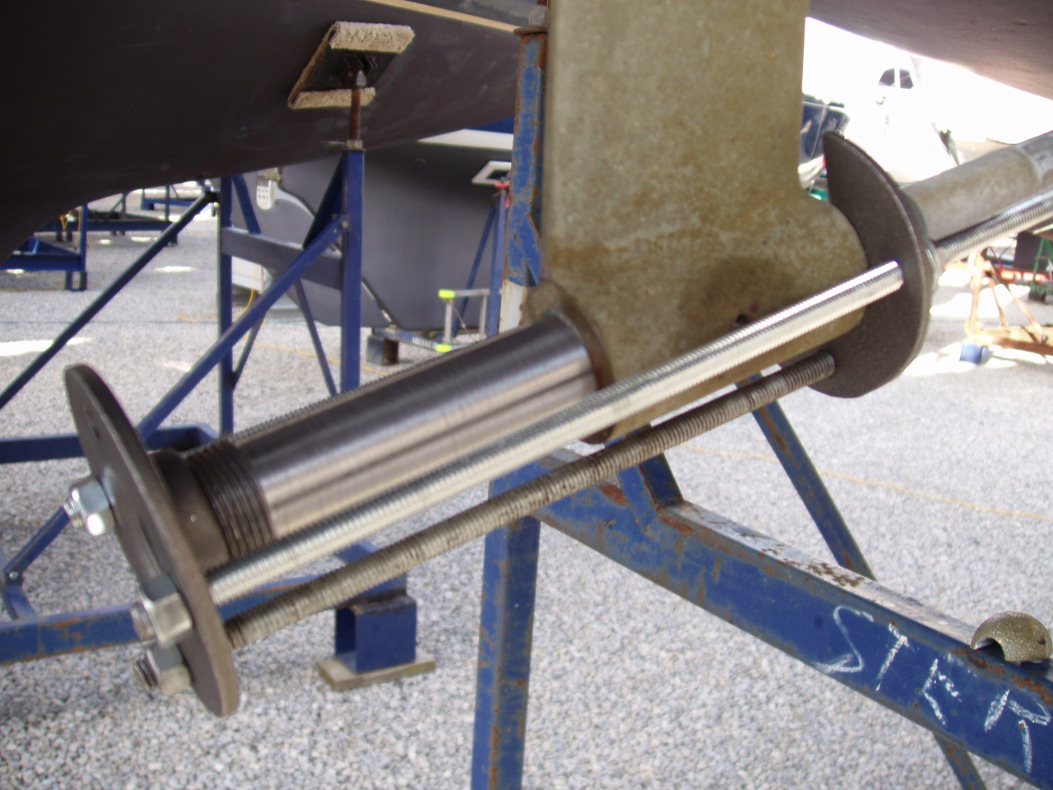

Here are a few images that I am not sure where I got them from. It is easily made from water pipe.

Alain, the C36/375IA has tools which Members can borrow, one of them is the tool to remove the bearing with the shaft in.
Read more at this link:
[url]http://www.c36ia.com/?q=node/23[/url]
