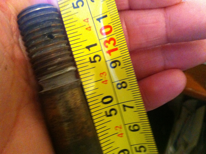

Catalina Direct is asking for the "set" length...can anyone confirm that? It seems to be the lenght minus the threaded end. I'm a liveaboard and I dont want the boat on the hard for two weeks while I measure, order, ect

Bill, I can measure it for you, but please make sure what a "set length" is. Let me know, as I have the shaft here beside my desk.
Thx Larry, take a look at this link from Catalina direct
[url]http://catalinadirect.com/index.cfm?fuseaction=product.display&product_I...
"Jem'nI
Cat 36 MKII #2004
Annapolis, Md
I get 50 5/8 inches by their definition.
