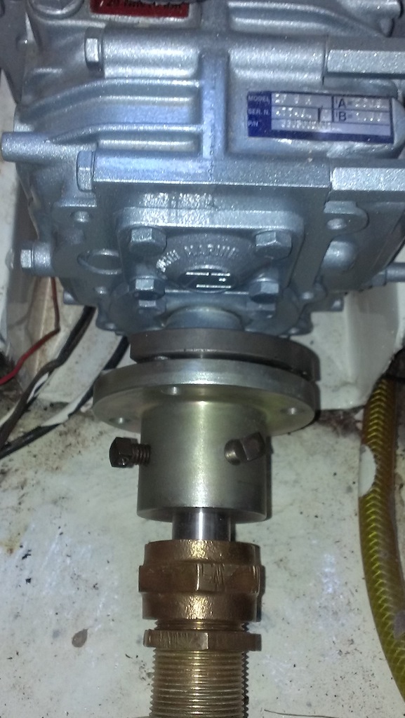

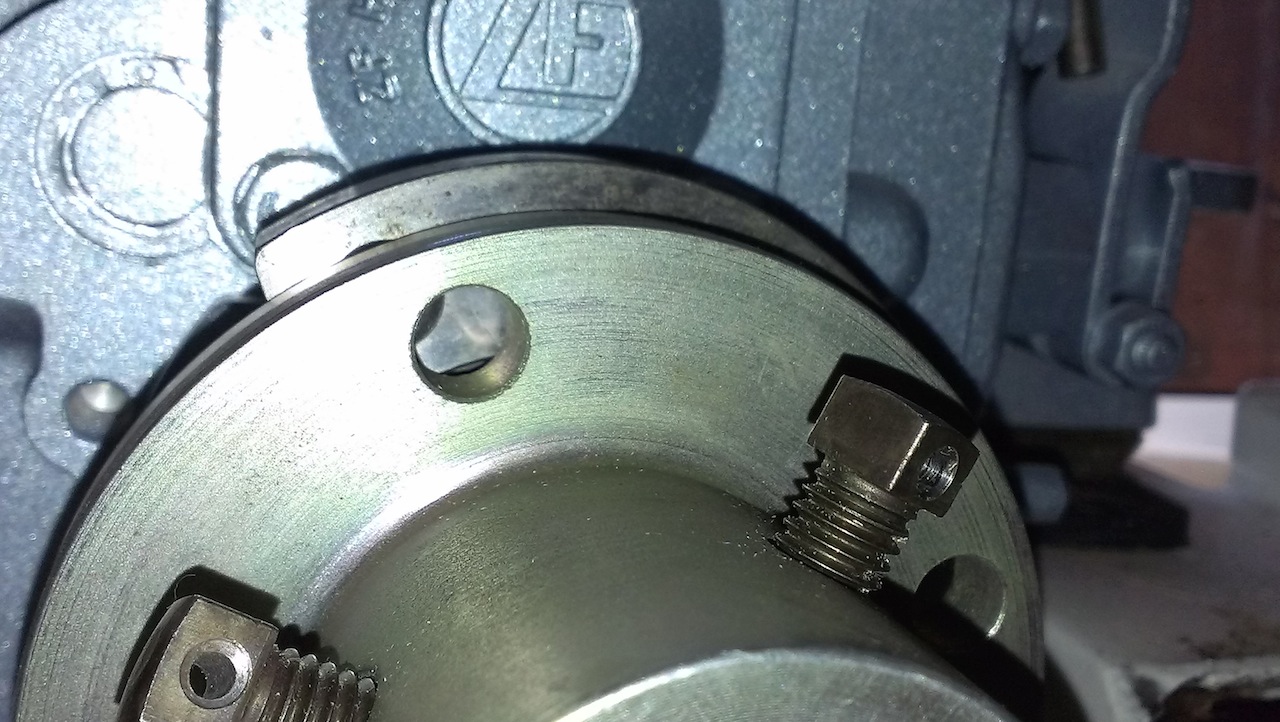

When I bought my new shaft from Catalina Yachts I also replaced the coupler and had the new one "married" to the new shaft. You should be able to clean the old one well and install it to the new shaft if its the same diameter. Just line up the key with the slot in the coupler. If its stuck to the old shaft still try heating up just the coupling and use a puller to remove it from the old shaft. Be sure to run wire back through the set screws to keep them from backing out while you are under power.
Below is a picture of the new shaft and coupling and the second picture is of the two set screws that need to be secured with wire.
Larry Robcke
