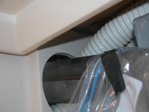

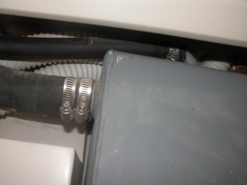

Let me offer what I believe is an explanation as to why some of our boats are difficult to fuel unless it is done slowly.
I have included 3 photographs to help illustrate my “slow filling theory”.
First, the area of our boat I am referring to is in the aft berth, the top of the fuel tank at the extreme aft end of the tank. The first photograph shows the larger main fuel pipe with the double clamps and the smaller black vent hose connected to the top of the fuel tank.
I decided to remove the vent hose to see if it was blocked by spiders or whatever. After disconnecting the vent hose from the tank vent, I pulled it downward, I had planned to push a fish tape up the hose and see if I could snag any blockage. What happened when I pulled the hose was a big surprise. About a ½ a cup of fuel poured out and onto the aft berth.
The presence of fuel in the vent is the clue to why we must fuel our boats so slowly.
Picture number 2 shows the plastic bag I taped on the end of the vent hose to catch the dribble of fuel but more importantly, it shows the large hole in the aft bulkhead created to allow the fuel fill hose and vent hose passage to the fuel tank. If you look closely, you can see that the bulkhead hole is lower than the vent (just out of view on top of the tank). For fuel to have remained in the vent hose since last September, there has to be a dip in the hose forming a liquid trap. Just like the trap under your home sink, fuel sits in this dip in the vent hose keeping the fuel tank from venting when fuel is added to the tank. This is why the fuel fill hose burps and spits unless you add fuel slowly.
So what to do?? Simple just eliminate the dip in the hose that created the trap.
I used an electric drill to drill a series of small holes going in a line upward from the top of the round bulkhead passage hole. After I made 2 lines of small holes with my drill, I used a larger drill to expand the small holes and with a screwdriver and hammer, broke out a slot for the vent pipe. Photo number 3 shows the finished slot cut with the aid of my electric drill.
Now there is no dip in the vent hose and hopefully no longer any need to baby the fuel nozzle.
I haven’t tried out this new vent hose modification yet and probably won’t fill the fuel tank until July some time but I didn’t want to wait until summer to pass along this theory. Please look at your own situation and judge if this vent pipe dip is (or is not) the cause of your lazy fuel filling.
While I am confident that I have solved my boats fuel problem, I admit I have been confident about enough other things to remember I could still be wrong.

As I mentioned in June when I started this thread, it would take a few weeks before I added fuel to my tank.
I would like to report that I have filled up my boat twice, each time adding over 13 gallons of fuel. Each time I filled up I used the fuel nozzle myself and I used a full, wide open, flow from the nozzle. Just like the power boaters do.
Not a single burp from the fuel fill hole, not a single shut off until the tank was full and the fuel started to come out the vent.
For my boat, the original vent hose path installed by the factory, created a "U" shaped trap that when filled with fuel, stopped the tank from venting during the fuel filling process. The same way a sink trap stops the odor from coming from the sewer pipe in our homes. The fix I described in the thread solved the trap problem and pumping fuel is now fun!
I consider the vent pipe routing to be a design flaw by the factory and should have been reported by the factory to boat owners. Having a fuel system that burps out of the fuel fill hole is dangerous and sloppy design.
I hope this problem is limited to just the 1993 age boats, the solution is so simple, I can't believe Catalina didn't change the design soon after the Mark I model ended production.
If your fuel fill hole burps fuel when you fill it too fast, I suggest you review this thread and pictures to see if your boat has the same flaw.

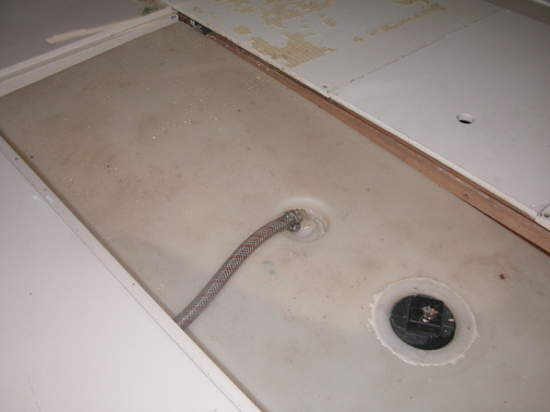

The aft starboard water tank vent is in the wrong location to work properly. If you remove the wood cover of the tank you will see the vent is in the top, middle of the tank. If the tank was level in the boat, this upper middle vent position would work but the tank tilts downward. So when you fill the tank the vent becomes covered by water before the tank is full. This causes the spitting as we fill the tank.
The vent should be located at the aft center of the water tank. But I can live with this vent problem.

I have a picture of the water tank in my boat.
