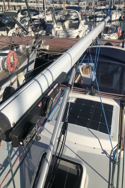

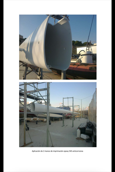

EUREKA's picture
EUREKA
Joined: 1/20/09
Posts: 130
We did a full refit of mast and boom, some seven years ago. Hereby some pictures. I have a full PDF report of work done (in Spanish)
Regards
Eladio Vallina
C-36 TR EUREKA II
Hull 1122 (1991)
Home port Barcelona (Spain).
