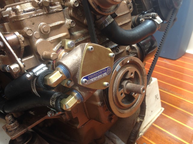

OK, replaced the pump this weekend. Went well BUT, one complaint: the brass “ears” that hold the pump body to the block are too short on one side. Looking at the engine from the front, the left bracket will only engage the pump shoulder if turned to approximately 45deg. This leaves only a corner of the bracket holding that side of the pump. The other one is fine. Poor engineering.

Did these "L" shaped mounting brackets come with the pump or are you using the ones that were on the old pump originally.
Try switching them from left to right. They may not be the same size.
Let us know if that helped to help others with htis problem.
It may be a good idea to let the manufacturer know to modify their part.
Here is how I modified and installed mine http://mei1970.org/saillavie/c36album/

They are the same, no left and right if you will. I got the “kit” which includes new brackets and they are the same as the original. Looking at the Sherwood pump, you can see that the bracket in question had the same issue as the paint shows that it was only held by a corner.
I plan on dropping a note to Oberdorfer.
