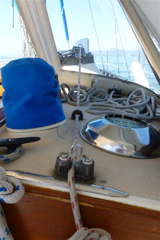

Thanks to both of you for your responses.
Stu -

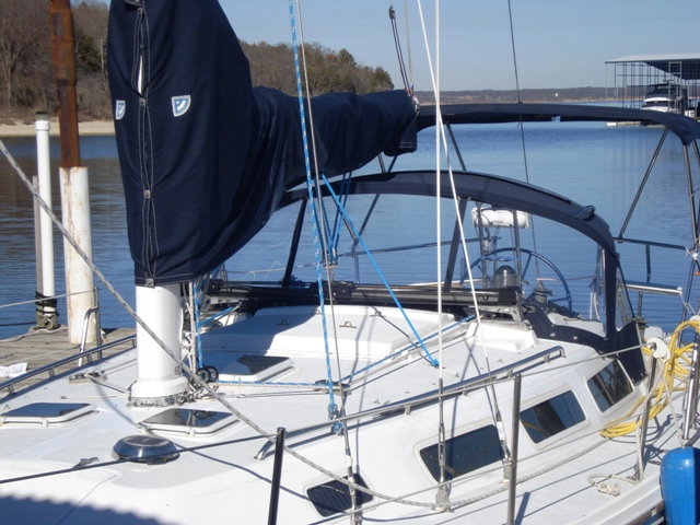

I hadn't seen an arrangement like yours, where the line actually leads through the window itself -- didn't realize that was possible. When I spoke to CD about the setup, they suggested a couple of turning blocks so I could get the line under the dodger. I'm assuming you don't have problems with the hole in the dodger window the way you have it set up, so that is intriguing.
I'm still curious why you are suggesting going with Garhauer over CD. Yes, I actually did speak to Guido at Garhauer and it seems the price is more or less the same with their set-up. Is it because you think Garhauer can "dial it in" more closely to my particular design (I gather that's why Mike Hogan went with it)?
Mike -
Any chance you could take a photo or two of your set-up, in lieu of an article?
Matthew, can CD do what Guido did for me? Can they take off the cam cleats? Our arrangement has worked great, since it makes it sooo easy to adjust the traveler car. What I did was to upgrade the traveler sheaves with Garhauer, then had the dodger rebuilt (it needed it anyway :)).
Also, from CD you're buying a "product", from Garhauer, you're buying support.
When you use the multiple blocks to go under the dodger, you're simply making it HARDER to work the car. I know, I've seen it on both C36s and C34s. I chose not to do that.
Your boat, your choice. :)

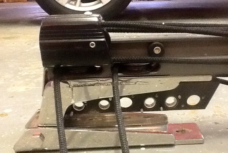

Just for context, I'm attaching a photo of the existing curved traveler track set up on our '85 C36 that has been so troublesome.

To answer your question, Stu, CD had told me the following:
"If you like, we can have the traveler supplied with Dodger Conversion Blocks that mount instead of the cleats. They will turn the line down, vertically, toward the deck. Cost is the same as it is installed in place of the cleat. You continue to use your old cleats. Since the new, flat traveler will be higher at the ends than the old curved traveler, it is likely you will need an additional block on deck to turn the control line horizontal again and lead it under the dodger or through the zipper near the bottom of the dodger."
CD sent me the attached photos of the traveler they suggest, as well as the block they would replace the cam cleat with.
In theory, Stu, seems to me if I set up the lines the way you did, i.e., punching through the dodger window, I could eliminate both the cleats and any turning blocks, and just add a fairlead to the cabin roof to guide it to the existing cleat, as you did.
So, thus far I don't see an advantage of one over the other, other than this:

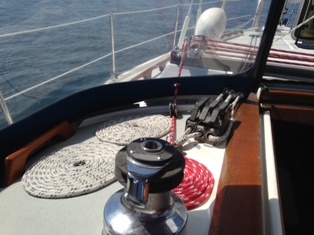

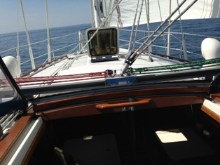

Mine include the rollers. You'd have to look very carefully at the picture I posted earlier to see it. They could also be used to turn the line down to the deck as you described. A roller (sheave) is the only way to get a fairlead off the traveler sheaves to angle it back, in my case through the dodger.
I don't know if you have a dodger or not, but if you do, the choice you have to make is whether or not you want to deal with doing the grommet through your forward dodger window or whether you choose to use the slit you have (if you have one) or go down to the deck and introduce even more friction in the system.
If you're comfortable with CD by all means go ahead. I've had nothing but praise for Garhauer. For me, if the prices were identical, I'd still go Garhauer.
Your boat, your pocketbook, your choice.:):):)
Anything else, let me know.

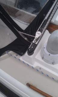

Try this photo -

[QUOTE=stu jackson c34;19004]Matthew,
I don't know if you have a dodger or not, but if you do, the choice you have to make is whether or not you want to deal with doing the grommet through your forward dodger window or whether you choose to use the slit you have (if you have one) or go down to the deck and introduce even more friction in the system.-[/QUOTE]
Stu - I do have a dodger (see photo in prior post), which is why I mentioned being intrigued with your scheme of punching a hole through the dodger window (with a grommet), which I hadn't seen before. Thanks for the closeup photo. I'll talk to my canvas guy to see if this is something he can do.
[QUOTE=Ciscocat;19009]i dealt directly with garhuer and they had no problem taking the cam cleats out all together and moving the traveler lines to one side (port).... i have the adjustment lines led down to a fairlead that then goes into a cam cleat, there are two on one side so that any adjustment that needs to be made to the traveler is done with the simple pull of one line (port or starboard) but on the same side of the boat.[/QUOTE]
Mike, that's a really interesting idea as well. Eliminates the little dance from one side of the cockpit to the other while adjusting the traveler. I like it.
(Oh, and thanks for the photo as well. At first, the absence of exterior wood, particularly the stainless hand rails, made me think I was looking at a MkII, but then I saw the solid hatch over the forepeak.)

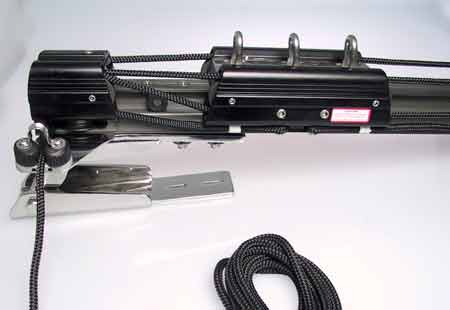

[QUOTE=jviss;19199]Regarding the back and forth between Stu and Matthew on CD versus Garhauer, please excuse me for pointing out the obvious if it's already been said, but Garhauer makes all of this stuff and CD resells it. So you're basically choosing to deal with CD or Guido... .[/QUOTE]
That's what I had thought in general, but the traveller replacement sold by CD (at least in the pictures, which I attached to my earlier post, about #9 in this thread, and attached again here) looks very different than the Garhauer setup I've seen in the various pictures in this thread. My initial query was focused -- I thought -- on the relative merits of the devices themselves, and although I've now gotten a lot of helpful feedback on folks' dealings with these two companies, no one seems to have an opinion about the CD traveller itself (apparently, no one here has ever installed one). Seem to be about the same price, by the way.
Ciscocat's picture
Ciscocat
Posts: 244
That is because they are the same CD gets the hardware from Garhauer and Garhauer agrees not to under price CD the attached is the set up I have

Garhauer makes a variety of travelers. The one your pic is one of the unibody travelers.
[URL="http://garhauermarine.com/catalog_process.cfm?cid=34"]http://garhauermarine.com/catalog_process.cfm?cid=34[/URL]
Ciscocat's picture
Ciscocat
Posts: 244
That's is the one I have mounted on my boat
Mike Hogan
s/v Ciscocat #226
Mark I XP25, std rig
[QUOTE=Ciscocat;19216]That is because they are the same CD gets the hardware from Garhauer and Garhauer agrees not to under price CD the attached is the set up I have[/QUOTE]
[QUOTE=Ciscocat;19224]That's is the one I have mounted on my boat[/QUOTE]
[QUOTE=jviss;19219]Garhauer makes a variety of travelers. The one your pic is one of the unibody travelers. [/QUOTE]
Ah, now I'm at last attaining clarity out of my initial confusion.
So, Mike, I take it that you are pleased with the "unibody" traveler (which is the one CD sells for our early MkI model?
This appears to be Garhauer's "MT-UB2", and now that I realize the CD unibody traveler is made by Garhauer, I suppose it really changes the nature of my original query, which now devolves to the relative merits of the "unibody" type over the sort of open-block arrangement of the Garhauer MT-2 that seems to be in most of the pictures of replacements installed by my colleagues.
Frankly, that seems like too much hairsplitting for me; since they are both made by the same reputable entity, I assume the quality and ease of use will be the same, so in the end it really doesn't seem to matter. Since the price is the same (and, alas, the cost of shipping to the right coast!), all that remains it a choice of who to deal with. Again, thanks to all who've contributed to this thread in response to my initial query!
