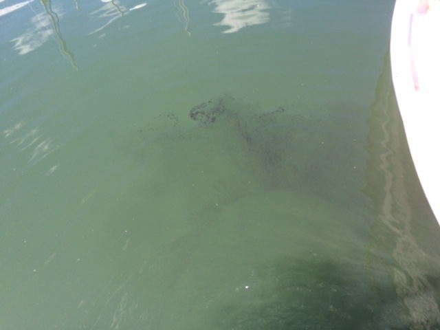

Oil in water at start up?
I'm new to diesel, so I'm not sure if this is normal. At start up, the waterlift muffler ejected probably a couple teaspoons of dense oil. It had been sitting for week. Seems to run fine with no other issues, always starts right up. Should this be something to be concerned about? See photo.
It didn't dissipate into a rainbow like a normal fuel spill, it remained in dense black blobs.

I am pretty god at gasoline engines but new to diesels but I would guess this is not normal.  My boat has a M35-B engine installed that is about 14 years old and when I start it I seldom even get a puff of smoke.  I would try a compression test and see if oil is blowing past the piston rings - just a guess.

This is unburned fuel. It is accumulated in the wet exhaust pipe and is blown out when you first start the engine. Basically the fuel is too rich and is not completely burned, it is sooth. This can happen if you idle for a long time at low RPM. Try running the engine at 2000 RPM or higher for 15 minutes. I would not be too concerned about it. My M35B does that from time to time and it runs just fine.
This is NORMAL!
What happens in a muffler?
It MIXES the exhaust GASES (think of the cr*p that's in there!) with the water.  If it's been sitting for a day a week or a month or an hour, it's gonna be some DIRTY stuff.
My advice: get used to it.
Good luck.  :)
My avatar picture, for some bizarre reason, is of my new exhaust riser, somewhat different than yours, but the identical concept.   Gases IN, mixes with the HX water output at the nipple, and goes into the muffler.  Right?
It has NOTHING to do with fuel.  Or shouldn't.

At shutdown, some exhaust elements are just not going to make it all the way out and will settle on the walls of your hose and much of this will drain back into the muffler.  Just for fun, here's the list of things you'll find in your diesel exhaust.  Not listed is the sea water and the science experiment that begins inside your wet exhaust system once it stops moving:
