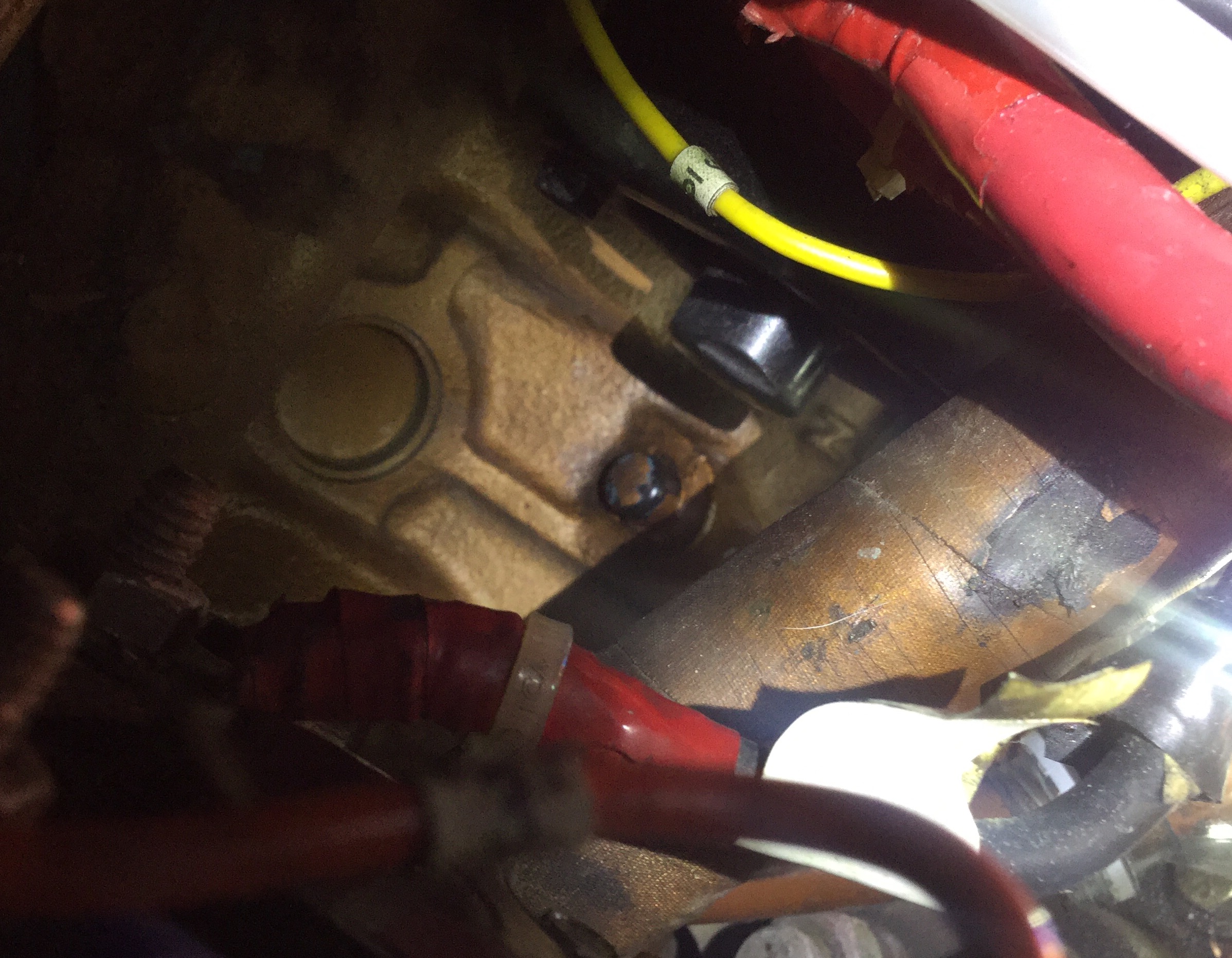

here is the picture of the engine plug...
Not loosing a lot of oil. A few drop in the bridge after a few hours

30W, 10W-30, 15W-40 are all specified in the owners manual.  I would not suspect that using any approved viscosity would result in more or less seepage.  Overfilling by 3/16" is normally not a big deal with the usual result foaming caused by the connecting rods contacting the oil pool.  Oil leaking around the pressure sender could be simply an indication of age.  Oil leaking out the front or rear seals could also be an indication of age.  Lastly, your picture seems to show a freeze plug and this would be unusual to have oil here since these are really part of the cooling circuit.
All this may point to something to check: make sure water is not getting into your oil.  An increase in oil level, oil coming out where water should only be, unusual seepage happening are all possible indications of this.

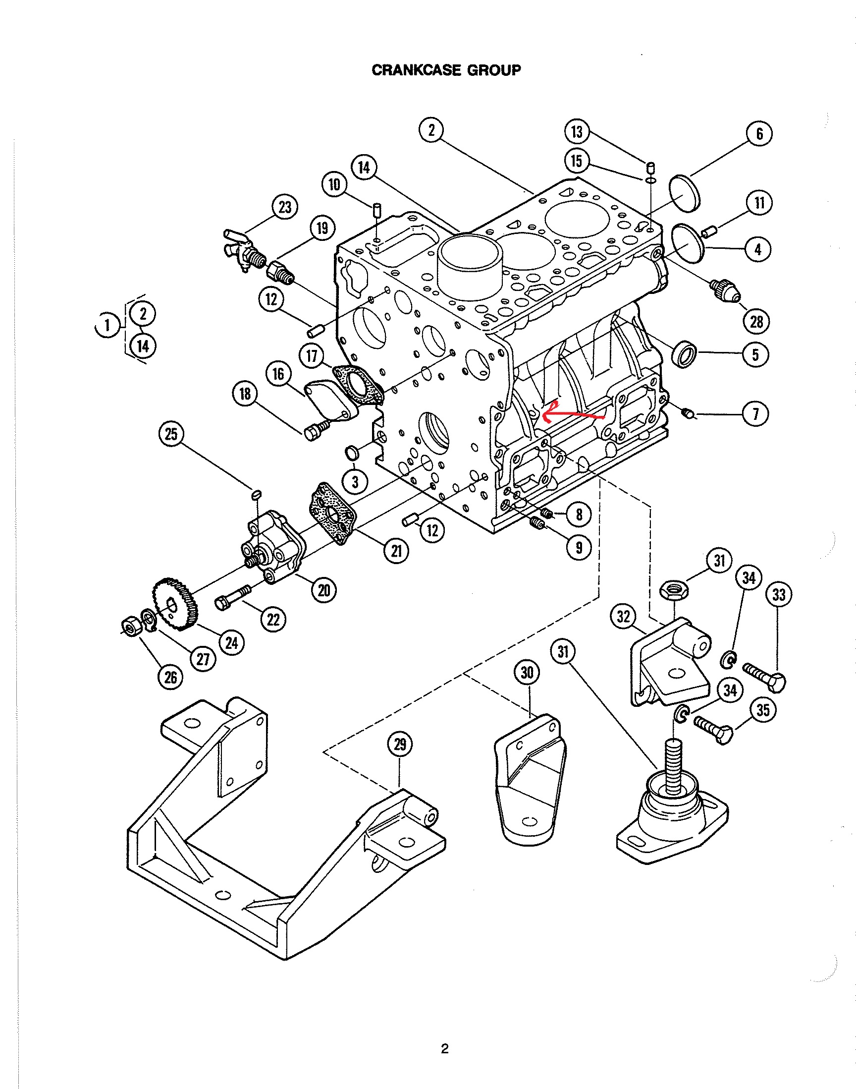

Here a drawing of the plug location. Is this a freeze plug? See red arrow!

Yes, generally for a diesel engine water in the oil will make the oil look brown when the oil is hot.  Given that your oil quantity is not increasing and you feel that overfilling is the cause for higher-than-normal level, then it's beginning to rule out the water-in-oil theory.  Since you see oil on both the pressure switch and a nearby plug suggests a common source, with the one being higher leading you to the source.
Usually those small threaded plugs are just plugging passages that have been drilled in the casting during the manufacturing process.  They are pipe-threads, so if the source of the leak is one of those plugs, tightening a bit may get it to seal.

Ok not coming from the alternator bracket.
The freeze plug is in fact un rubber plug..... So Íll chck with kubota tomorow if they keep that part. Probably rubber is harder than it was.
ill change the plug and the sensor this weekend and start from there.

Most freeze plugs are about 1" diameter and either just pressed in or have a nut that you tighten and this expands a rubber bung.  Again, oil coming out of a freeze plug would not be a good thing as it's a water seal.  If you remove a true freeze plug, be aware that you will loose all of your coolant.
I think just change the oil pressure switch and see how this goes first.  Aside from seals, the only other likely source of oil would be one of the plugs that is used to seal up the oil galleries after manufacturing.  These are all-metal and just thread into the block.  Any leaking might be able to be stopped by a slight tightening.
