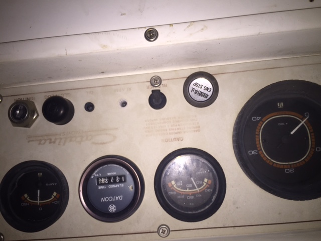

I am the proud owner of a Mk1 1984 36 with a universal engine. After one month of owning and sailing, I now have an oil light, and audible alarm that goes off on the key panel when the ignition is in the on position prior to starting the engine. I have also noticed increased oil in the bildge.
When I start the engine the alarm goes off after a few seconds.
Any ideas as to where I should start trouble shooting and possible issues.

When I turn the key on but have not started the engine I always get a buzzer warning because the pump isn't pressurizing the oil system yet. Having oil in the bilge is a different issue though.

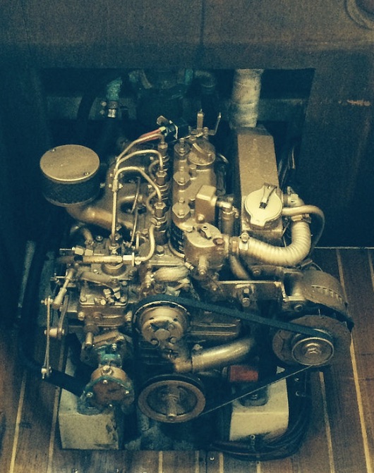

I'd check the oil filter first to make sure it isn't loose. You don't mention what engine you have (I have a U35BC) but on mine there is a bolt on the front starboard side of the engine; I had a slow leak through that once because it vibrated loose. Then of course you could check the oil pan itself under the engine to make sure the bolts are tight and there isn't a rusted out spot in the pan. I guess you'd have to use a mirror to check that or run you hand around under the engine.

Chuck- Thanks for the insight, i'll check the oil filter and bolt for leaks. I have attached a picture of the engine but i'm not on the boat so i can't get a model number for you other than knowing its a 25hp universal 1984 vintage.

Mark,
Carefully check the condition of the oil pan with a good external examination. They have been known to rust through and seep oil into the bilge. I hope that's not the case with yours and hope it is something simple like a loose filter.

That's precisely what is supposed to happen.  The alarm should ALWAYS go on whenever the key is put in the on position but the engine is not actually running, because you have no oil pressure at that point.  I'd be concerned that the alarm isn't working properly if that wasn't occurring in the past.
