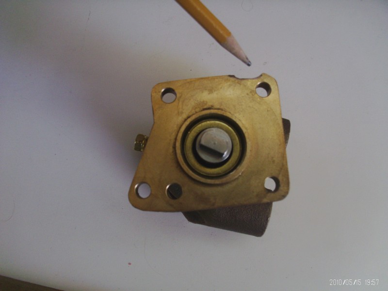

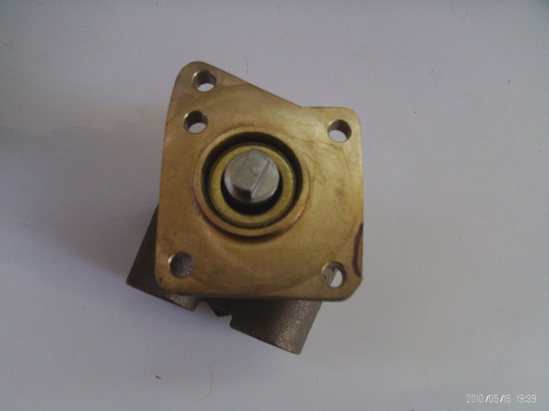

Unfortunately, the water pump mount for the M35A is totally different and it doesn't look like that mod will work on it. Possibly could still be done using the same concept but would need something brazed on to get correct height for the mounting tabs.
Fortunately, I just got a brand new Westerbeke 42175 G908 pump off eBay for 300 bucs. So I am OK for now I guess.
Just a FYI for ones with a M35A. I just used a N202m 16 Oberdorfer Pump in place of my Sherwood Water Pump. It only takes a little mod to make it fit. I used my dremel and about 2 min of work and it fit. The easiest mod there was I think. I have pictures but I need to figure out how to get them smaller so I can add then on here.

Here's the pictures Randy did, I shrunk them down to post them. Wow, what a simple little deal. And I just blew $300 plus bucks on a Sherwood! Thanks for that Randy, this will no doubt be very handy info in future as these boats age.
Thanks Bud:
Larry I sent you a email as well as Bud and yours came back so I sent you one through here the web site, Once I get everything caught up I will figure out how to downsize the pictures.
