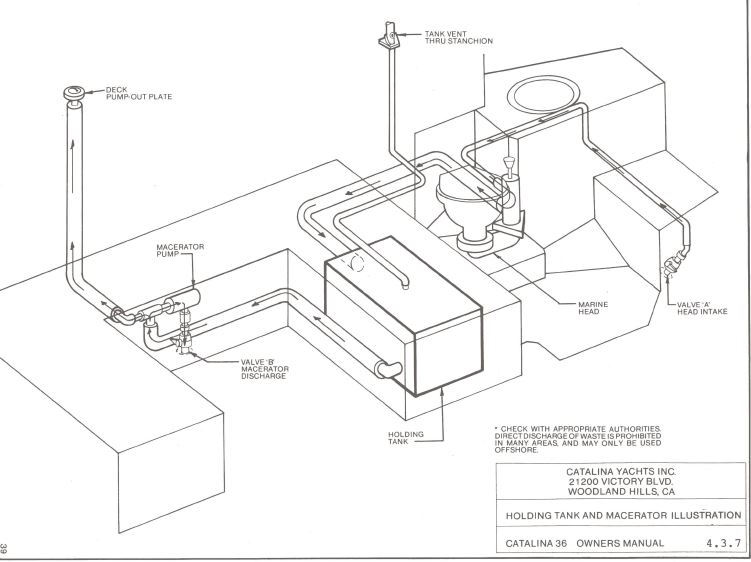

Thanks guys - anyone have a handy pic of an original configuration?

This is the diagram and loop from the manual.  I also have a mk1.5, and the only thing different in my setup is that the holding tank is actually mounted longintudinally over where the diagram shows the macerator.  As for rigid pipe, I have read that PVC is probably not a good idea, as the motion of the boat causes a lot of stress on rigid pipes that will eventually cause them to crack/break/leak poo all over the place.  However, many people have replaced their plumbing with PEX with great success *although I do not know if it comes in large enough diameters for all of your sanitation lines).  It is rigid but has enough give that it can take some movement without issue.  Don casey, the godfather of old boat maintenance, recommends PEX for plumbing replacement.  My personal experience was that I wanted to use PEX for my freshwater lines, but with all of the tight spaces, corners, bends, etc., it was much easier to just replace with new marine hose.  I have not had to do the sanitation hoses yet, but will probably go with hig quality hose when I do.
