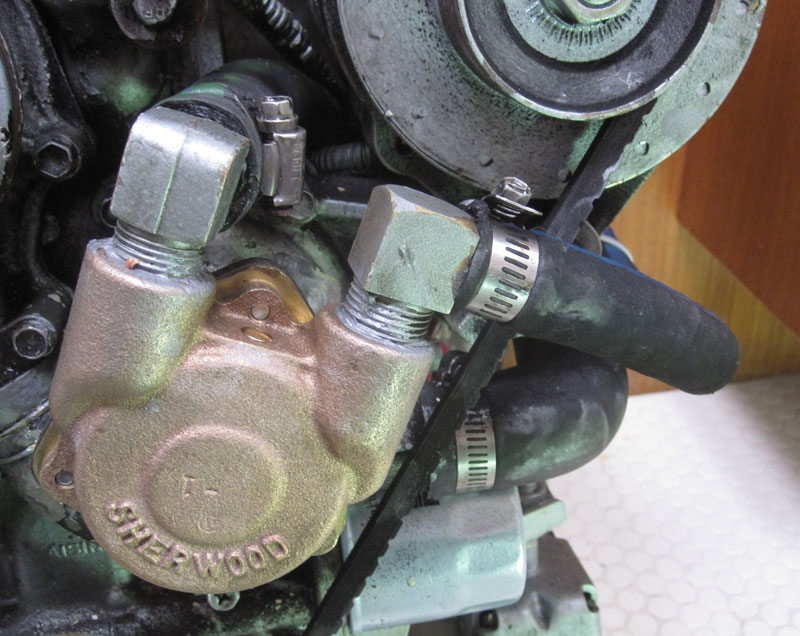

Our engine is a year older than yours, 1167 hours, runs very well. I have one in my farm tractor, in industrial applications these engines easily go 5000 hours and 10000 is not uncommon. I would not consider replacing it as long as I can get spare parts. For sure I would never swap it for a newer M35B series engine or any other engine where the drive belt cannot be removed due to having water lines or any other obstruction in front of it. The Beta 35 and 38 are such engines, there is a steel pipe running from the water pump that blocks removal of the drive belt. Drive belts break and when they do you want to be able to change it quickly. They are good engines, but that one feature would stop me from having one.

Yeah, I am hinky about that because once I had a brand new drive belt break when it had about 3 hours on it. It broke, naturally, at a very bad spot, rocky shore wise. But because there's no obstructions on the engine I can change it in 5 minutes, tops. I keep a spare belt right there at the engine that is 5 mm longer than stock and is super easy to get on and tighten. I guess when something like that happens it tends to shape your thinking, maybe too much?
The best fix for this, for me is to use the OEM style belt, which is a Dayco TopCog. I tried 3 Napa belts with bottom cogs on 2 different engines and not one has not made it to 25 hours without breaking or delaminating. The Daycos shed rubber for the first 10 hours, then they just settle in and work with very little dust and wear.
But isn't it a real pain in the butt to have to take a coolant line off to change the drive belt? That's a lot of hassle.
It's really not a hassle to remove a hose from the raw water pump on the M35B. All I need is a screwdriver, and I can have that hose off and back on in about, oh, 1 minute 30 seconds. It's a raw water line, so it's not under pressure.
