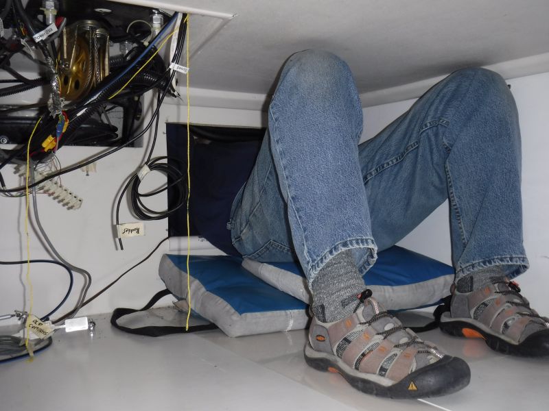

I have had two, wheel pilots, and last spring I installed a below deck EV-200. It can be a little claustrophobic (I'm 5'10") and it was a PIA, but once done it was a big improvement over the wheel pilot. It tracks much better, it's quiet. If the wheel linkage fails you can steer electronically. The wheel pilot sucks with following seas and occasionally forces me to hand steer. The EV-200 handles those conditions nicely. The second photo was during a rudder replacement a couple of years ago, it's tighter quarters in there now. I keep a cell phone handy when in there.
