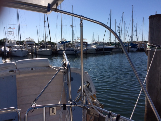

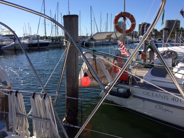

Here are the pictures I promised.
One shows the four solar panels.  I got the stainless steel supporting mounts from EMarine Systems in Fort Lauderdale.
Another shows one of the middle supporting strut (angling down from the center of the wooden piling to the right side of the ropes) and gthe forward supporting strut on the far right edge of the picture.  It attaches to the upper part of a stanchion (not shown).
The third shows the aft supporting strut at the far right edge of the dinghy.
As you can see, there is room for another four which would bring me up to 800 and I think the beefed up bimini frame will hold the weight ok in all but a major storm (in which case I plan to take them all down).
Ben Ethridge
Miami, FL
1984 MK1 Hull# 263

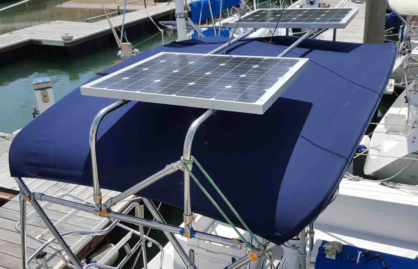

Just thought I'd share my solar panel installation.
Picture speaks for itself.
Bill Matley
