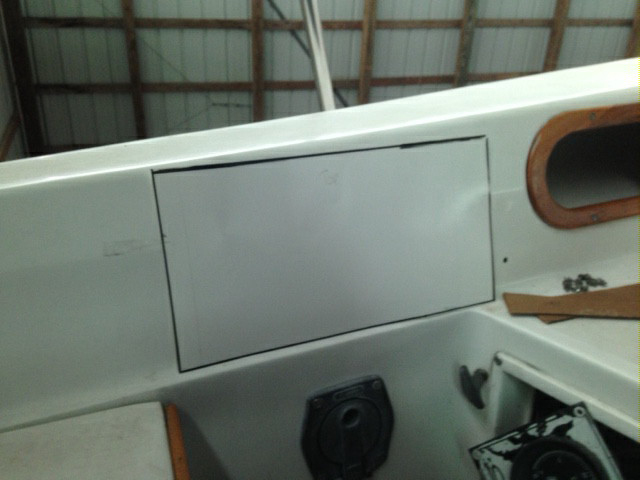

See attached picture shows the opening size needed for the angled pod, as you can see the hole takes up nearly the entire coaming, leaving no room for the flanges of the pod.
Howard ("Mike") Cann

I'm thinking you need to move it a bit aft and parallel with the top of the coming.. I actually think it goes closer to pump as well. It's neat how you store your boat upside down :)
