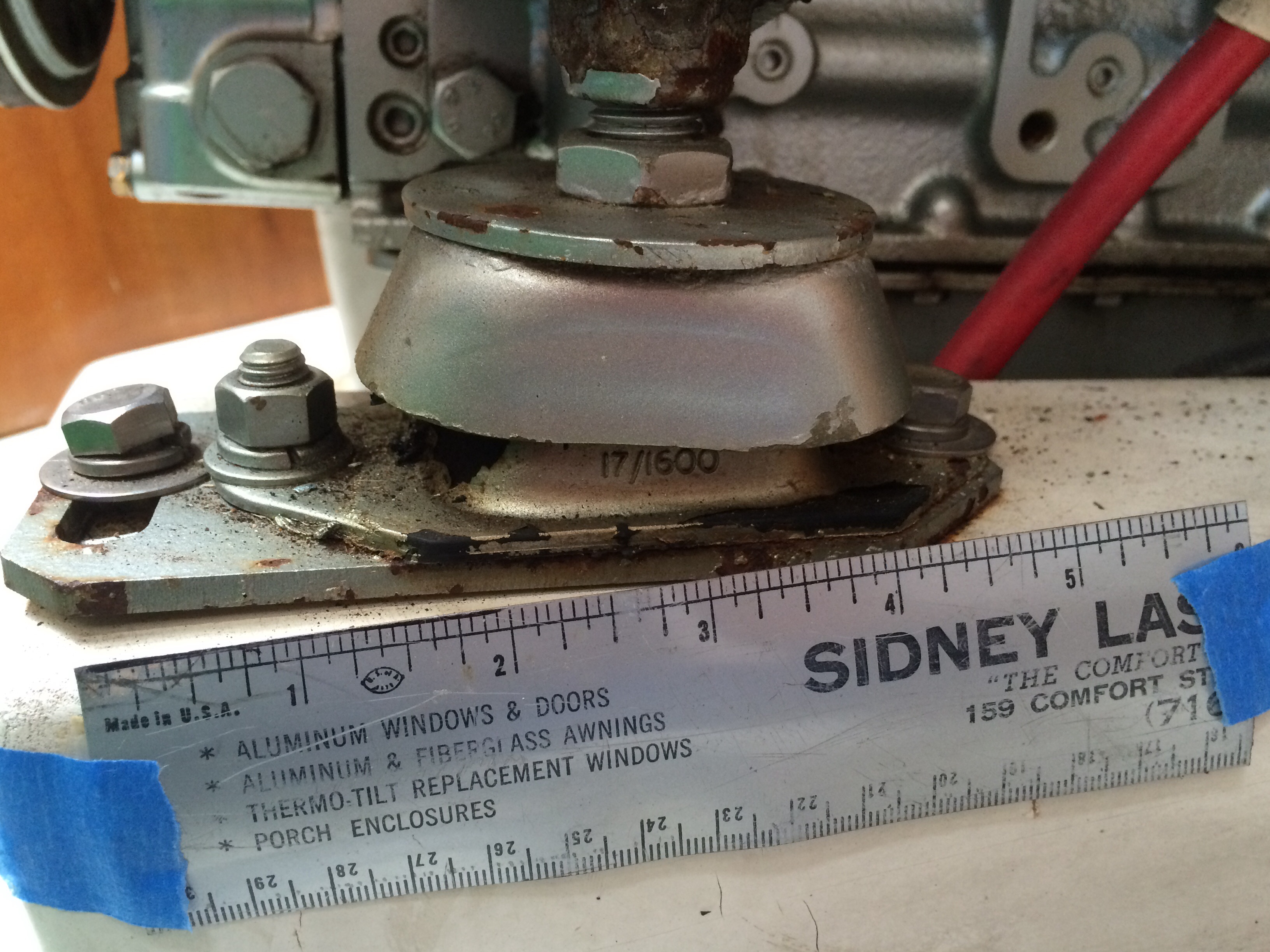

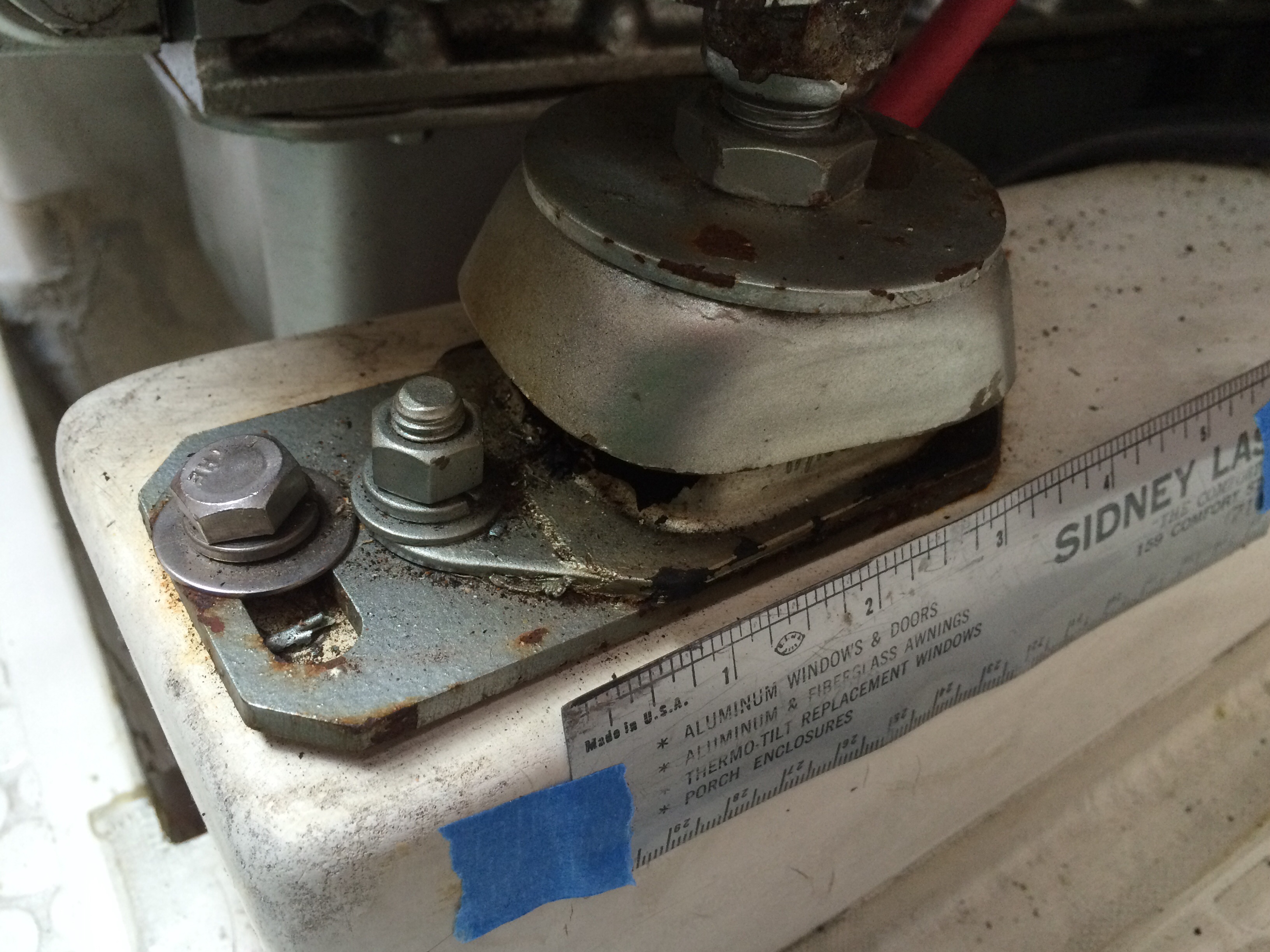

I have spent some time searching the archives on this site and they talk about 4" and 5" mounts. Went to the boat to take a look and mine seem to be both. There is a plate mounted to the stringer with 5" mounting holes, but on the plate there is a stud welded to it that the engine mount seems to mount to. The distance between that stud and the back hole if the plate is about 4". Going to attempt to attach some photos. If in fact that is how my boat is set up, going to look at the vetus k75 or 100 mounts.

replaced all 4 motor mounts with Vetus K100 mounts.  Did the job, when removed they were toast.  Everyone I talked to said, 20 years way too long to eclectic a motor mount to last.  I guess they were right!!!
