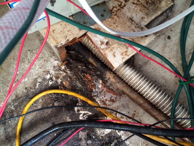

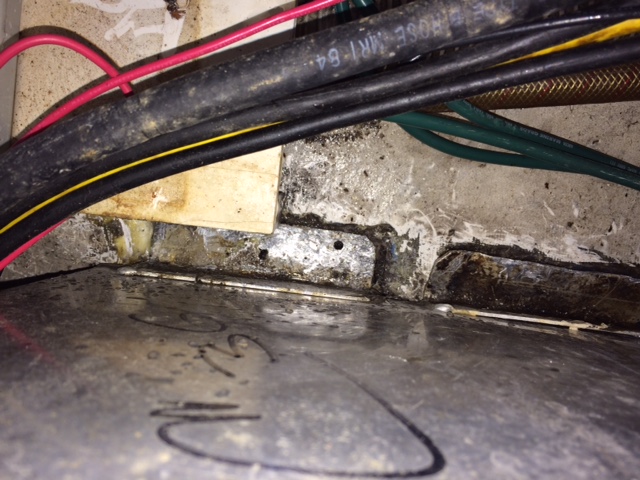

In addition (and assuming that the previous owner has not altered the setup from the factory), the fuel tank tabs are glassed-in in such a way that you cannot remove the fuel tank without also cutting out a section of the water heater wood mount.  In the attached pictures, you can see the tabs AFTER we cut them out of their glass with a dremel multi-tool (saw) but  BEFORE we used the dremel to cut away the section of the water heater mount.  Then the second picture shows the water heater wood mount cut away, at which point the fuel tank comes out relatively easily....
...but on the whole this project was a dirty, messy PITA. I'm now buying a new tank from Catalina with two inspection port holes, but  why I'm making that choice when this tank does not appear to be corroded should probably be the subject of another thread..

This is exactly the issue I am having. I was planning on using a dremel to cut away a small piece of the water heater wood mount, enough to clear the tank tabs. Thanks for confirming my suspician.

Even after cutting away all the fiberglass above the aluminum tabs, we still had to pry the tabs out of the hull with a chisel.  What a pain!
