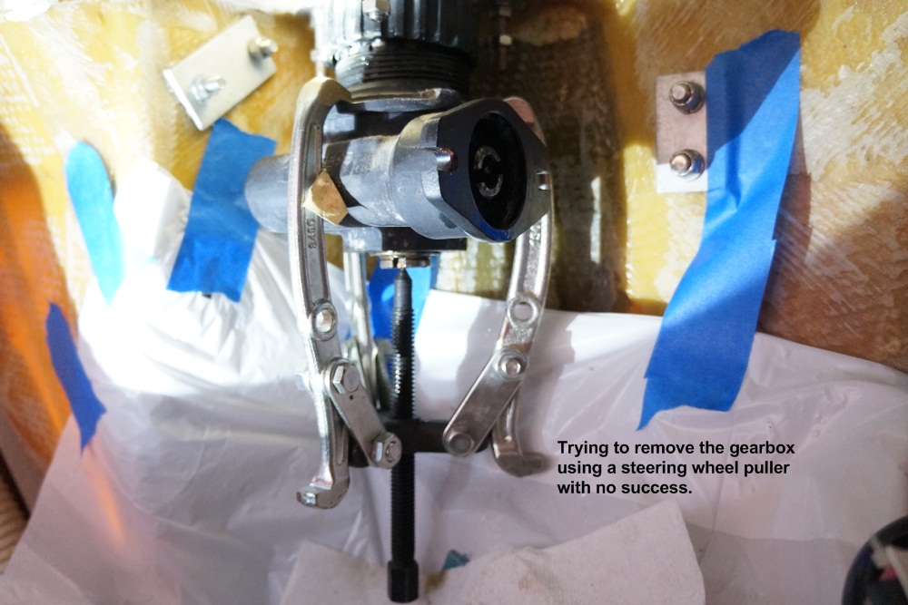

Duane, I read your post with much interest as now I am at the same point.
I heard the squeaking when pulling up the rode. Eventhough it worked just fine, I decided to remove the gearbox and pull out the shaft to clean the mud with no success. I used steering wheel puller.
Last time I attempted to remove the gearbox was 9 years ago in 2015 and I gave up.
Read more about my story HERE
Yes, cutting it off at the bottom and installing a new RC8-8 with capstan is just $2000.00.
Since I greased and applied WD40 the squeaking has stopped, so I am going to leave it alone for now.
