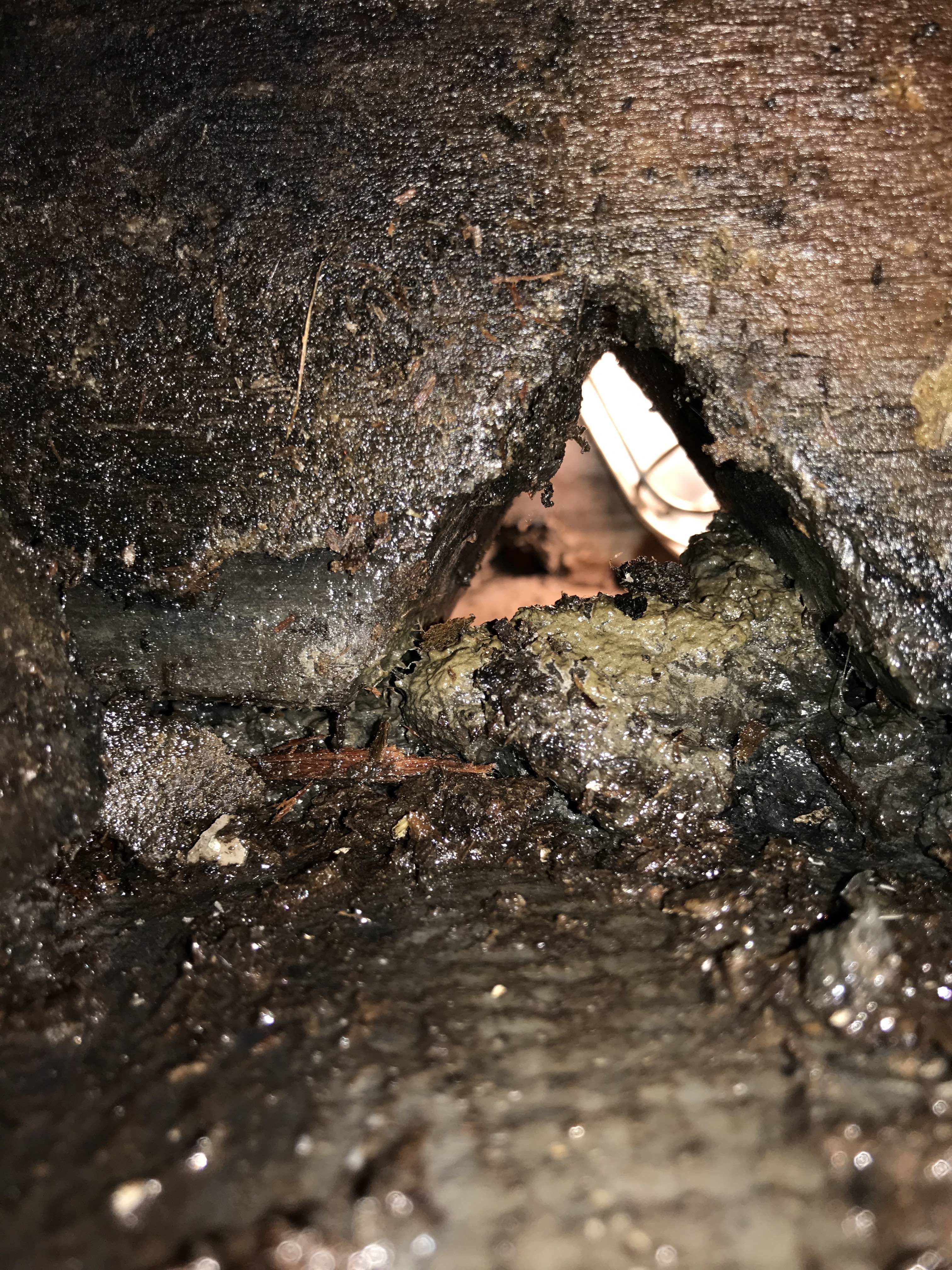

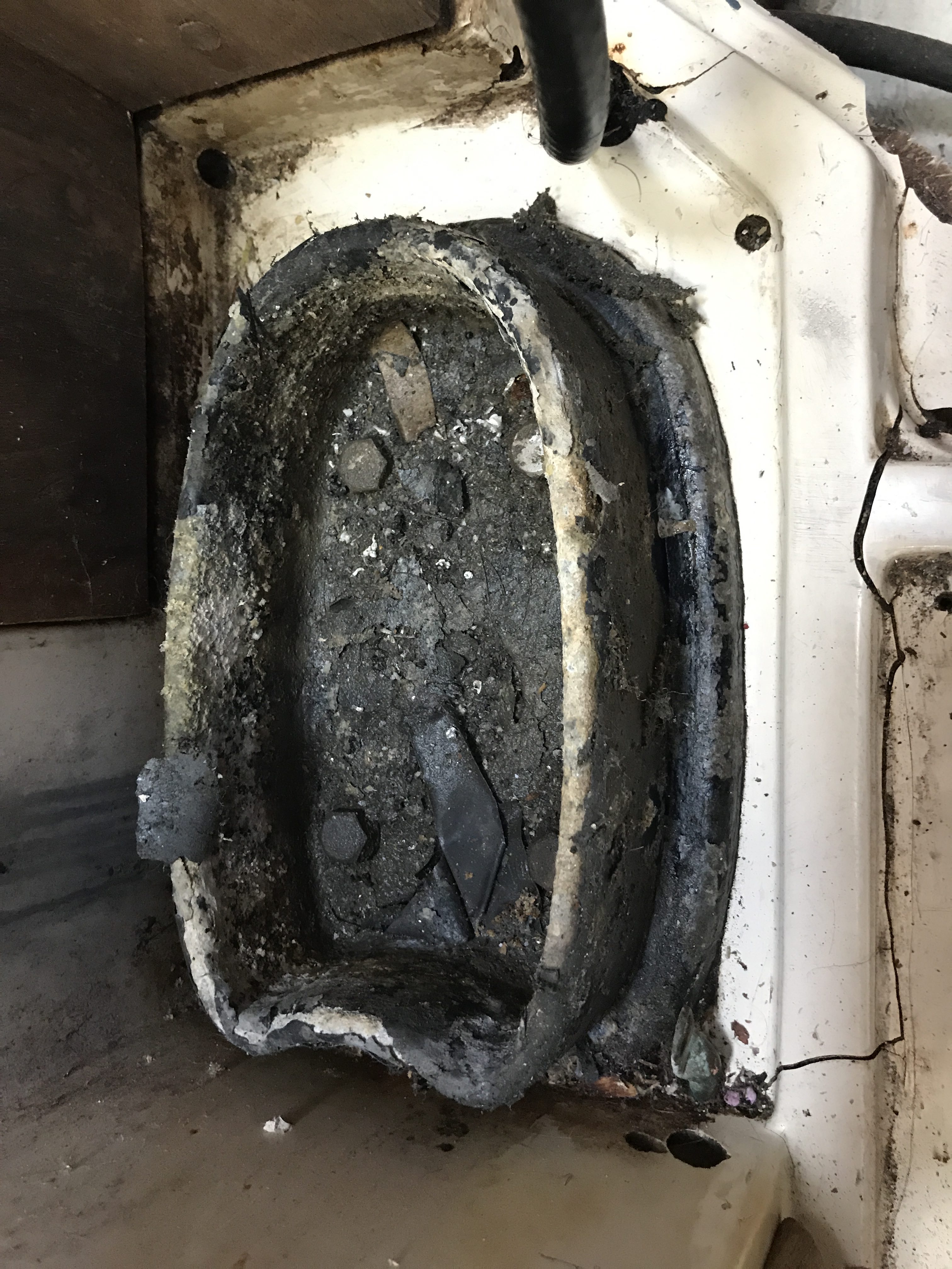

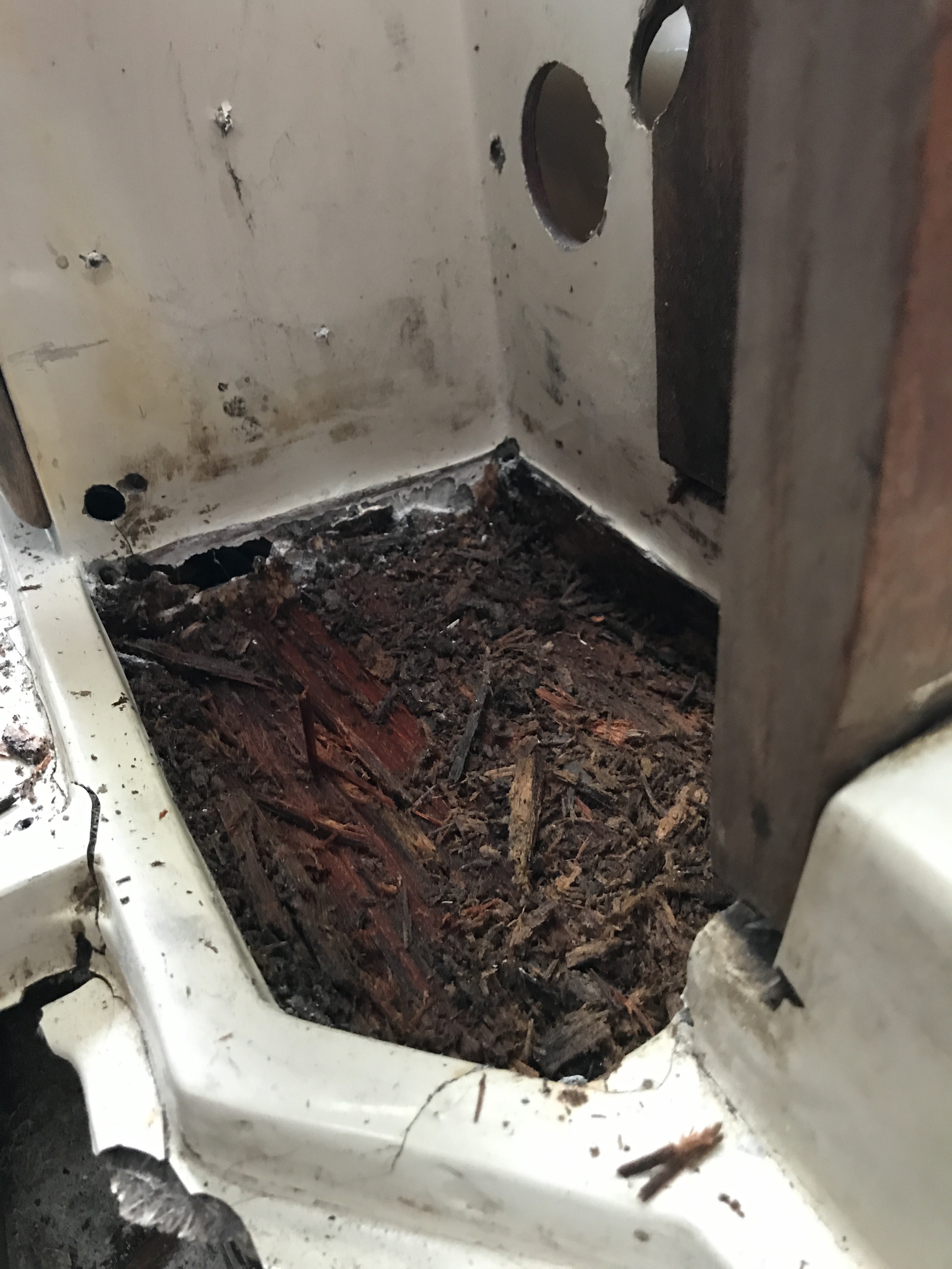

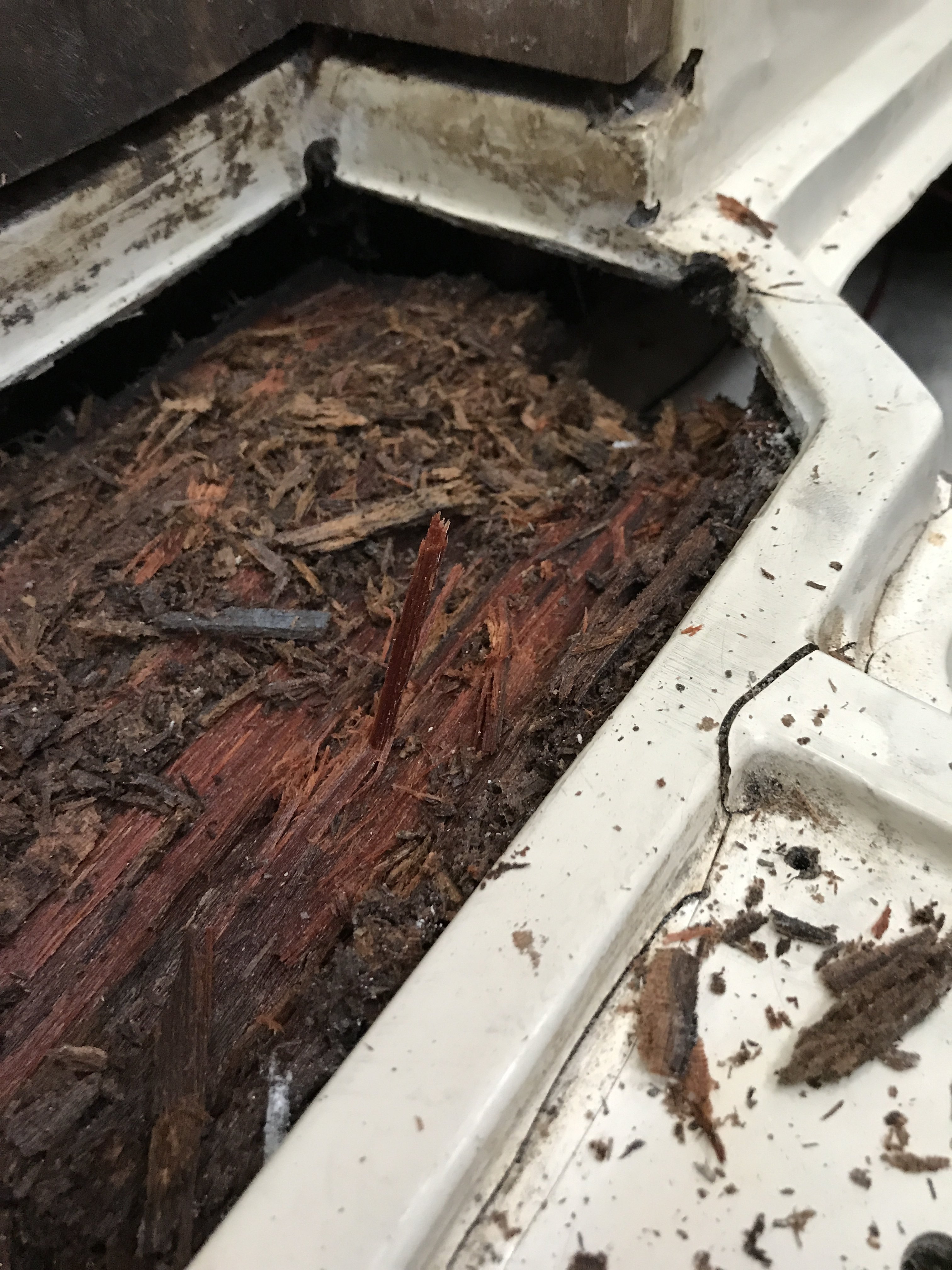

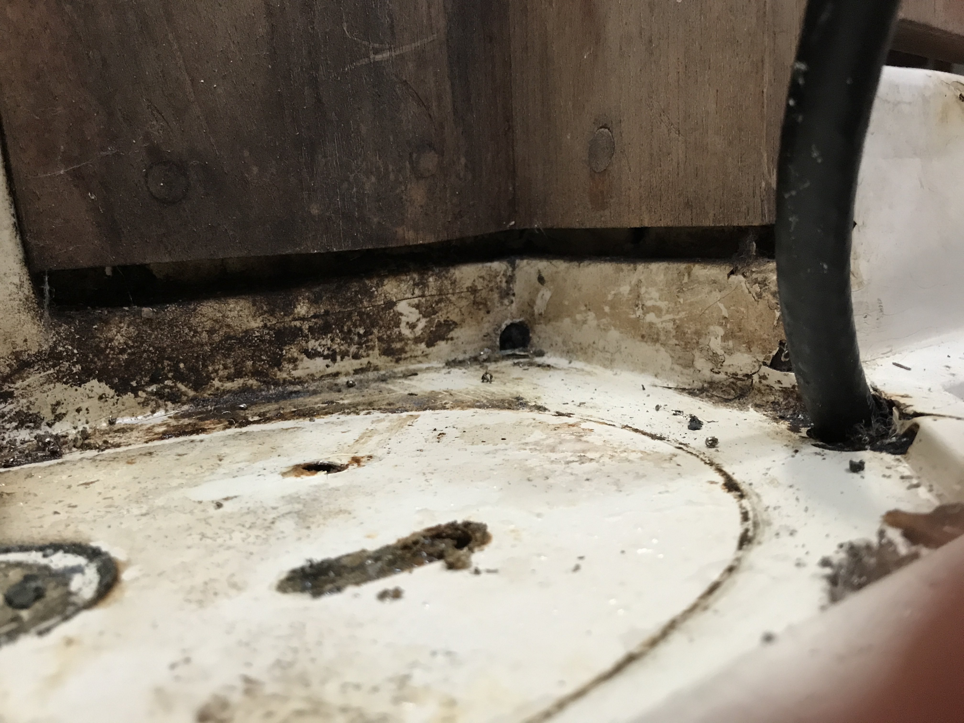

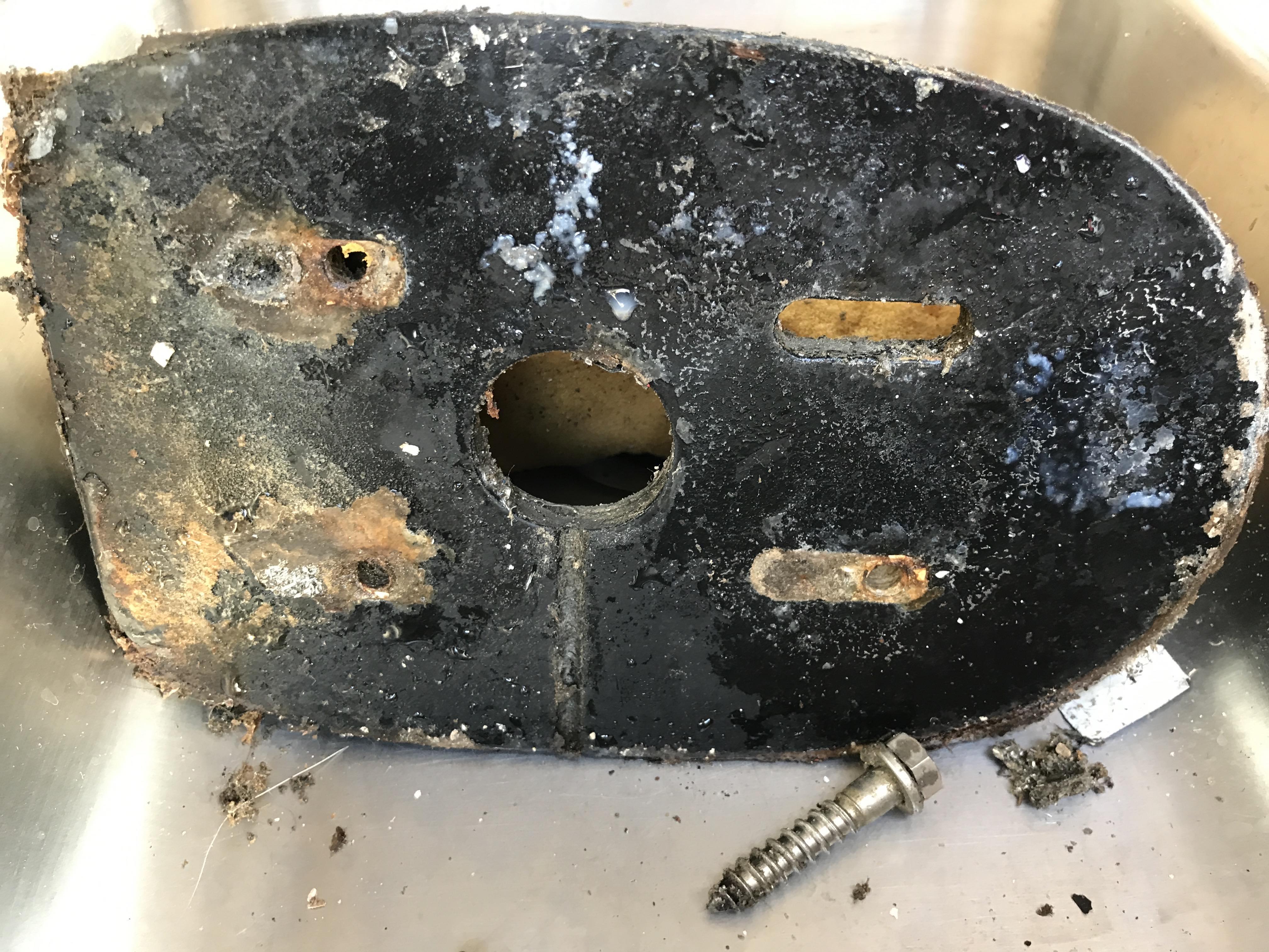

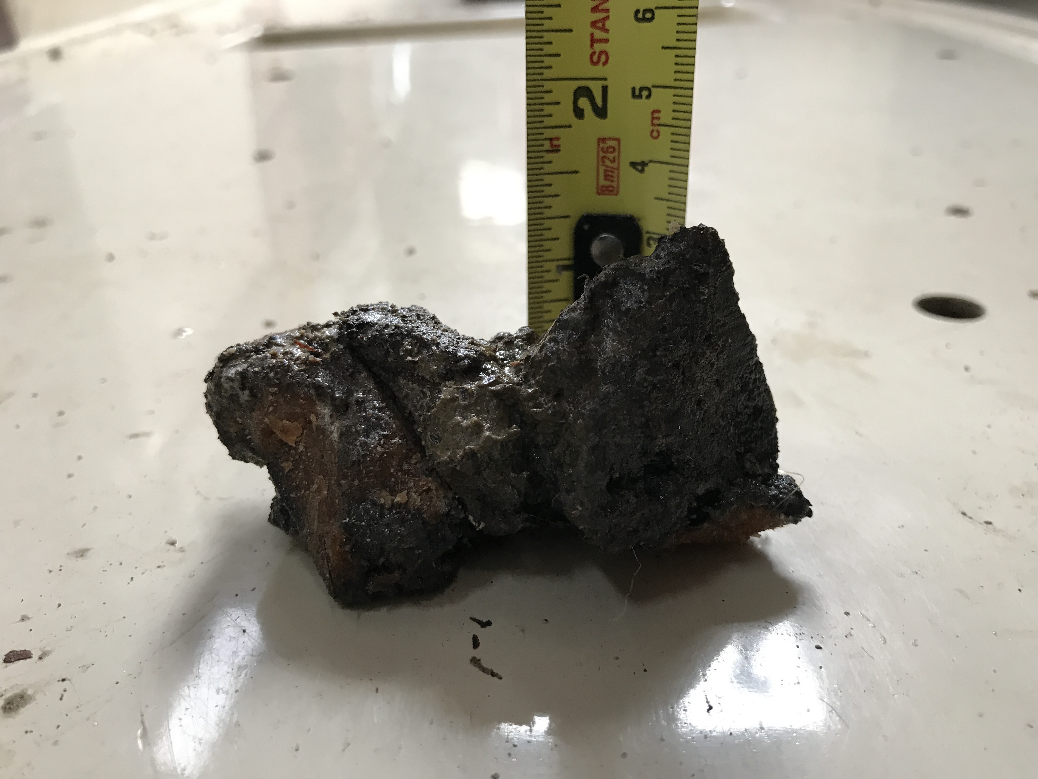

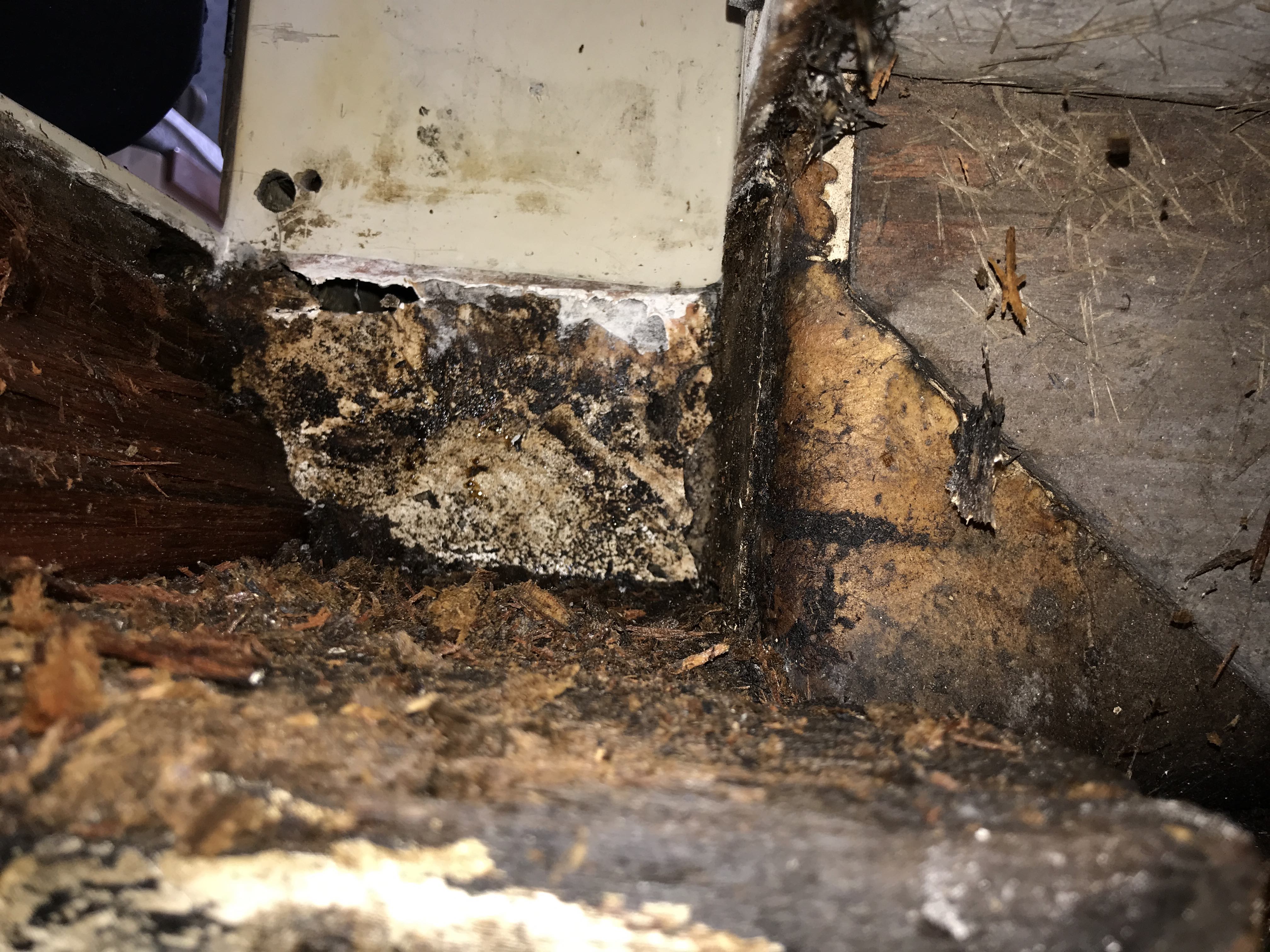

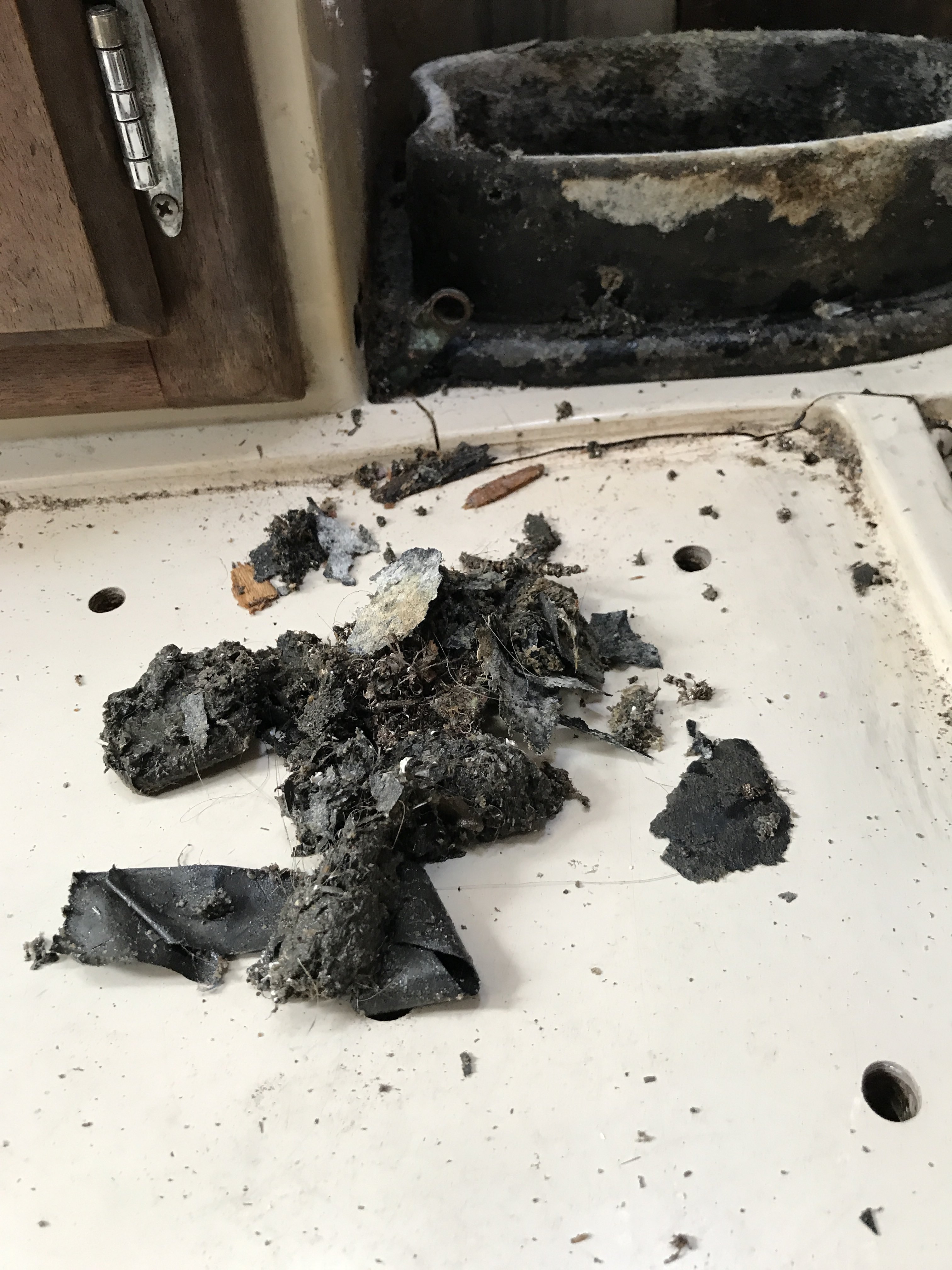

The mast is out, the base was completely full of crap and most of the water must have been seeping through the screws into the wood.  Once we removed the base we cut out the floor to access the step.  Then followed hours of fun with a screwdriver and hammer.

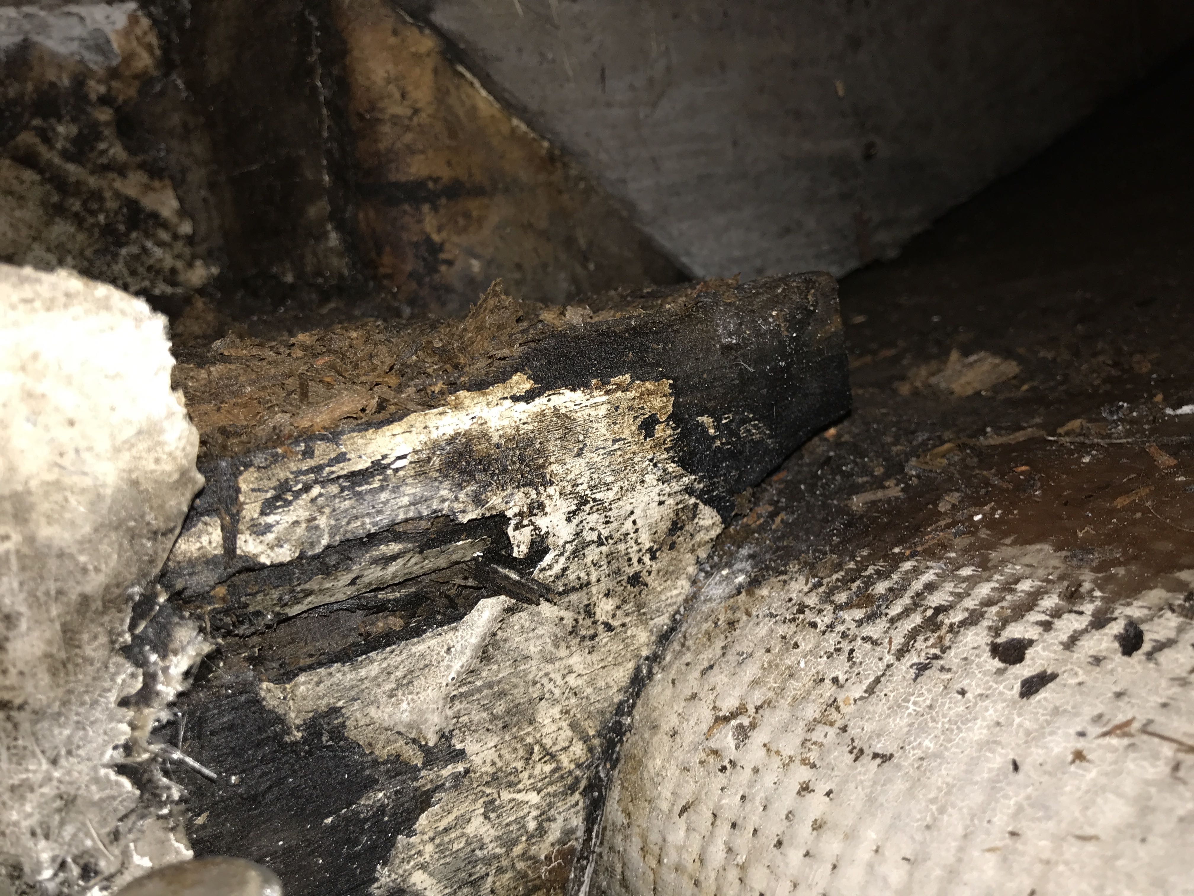

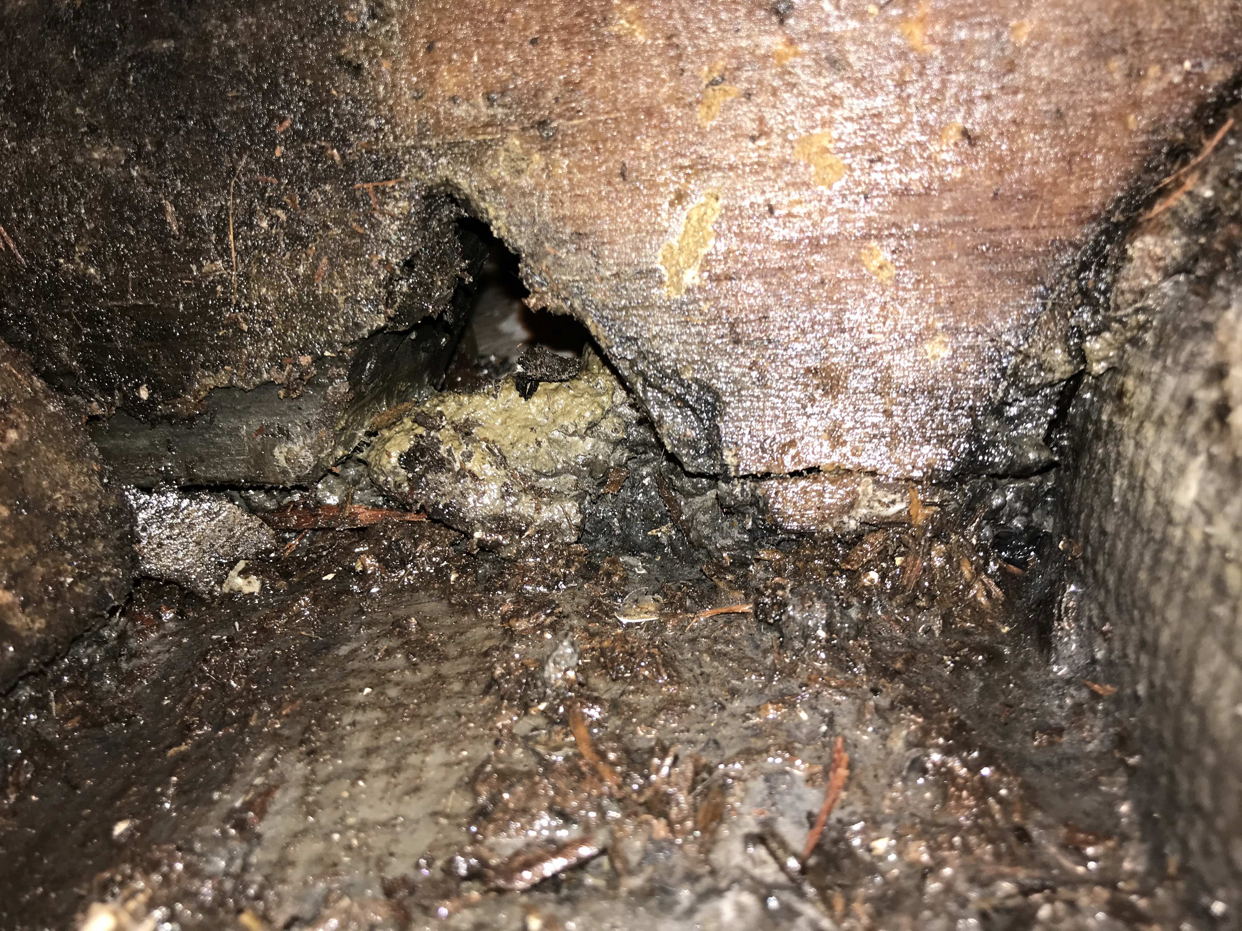

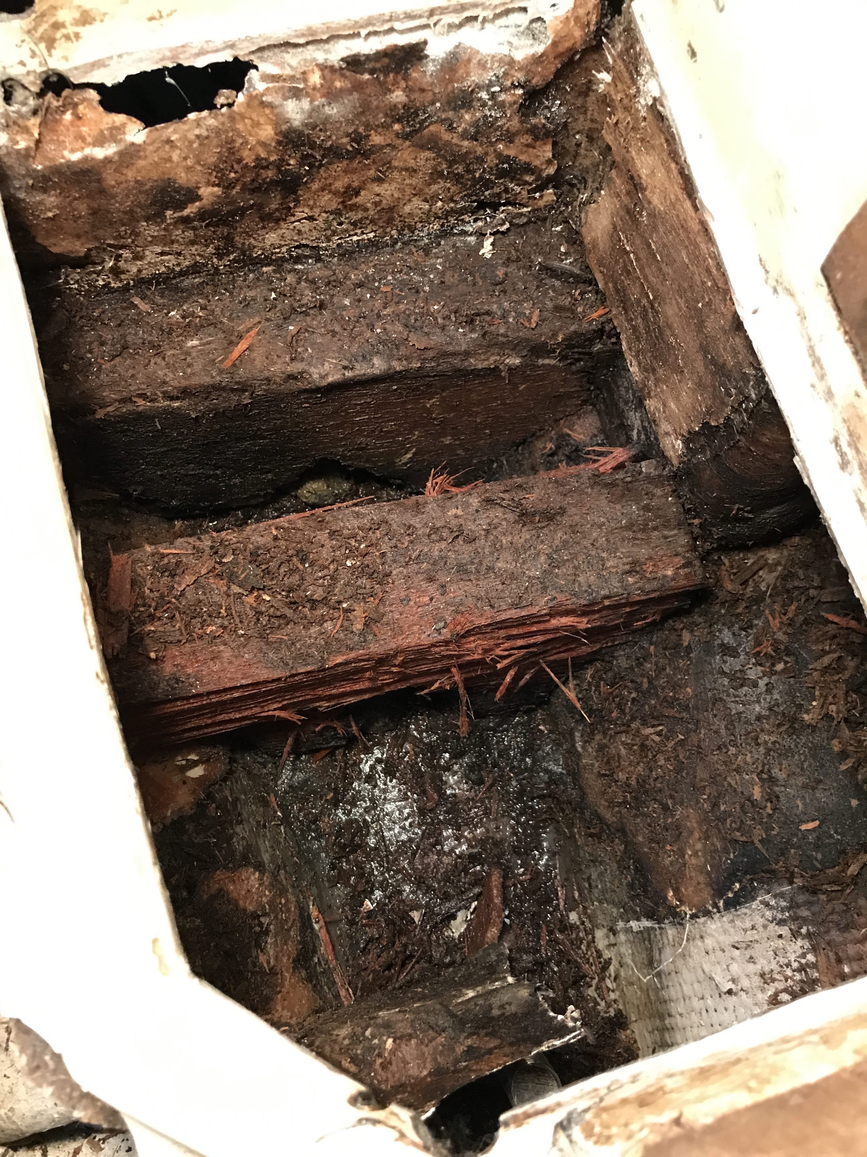

Once the top block was out I was able to access the bilge section which is 3 vertical blocks, cut to fit the turn of the bilge with a V notched into the bottom for water to pass through.  They were originally bedded with some fibreglass resin goop much of which was blocking the flow of water from the forward bilge to the center.   Since the bottom blocks were unprotected and almost always sitting in water it makes perfect sense that they would be soaking wet.   I am sure the drain being half blocked did not help......
I removed the first block in pieces, the second one came out mostly intact and the aft one actually looked pretty solid so we will leave it in place.  Today I am going to hunt for some IPE to replace the lower blocks and then we will rebuild the top with marine plywood, resin coated.
It feels good to know what we are dealing with and to have a plan.

Bottom blocks, left the aft one in place as it was in good shape and would have been the hardest to remove and replace.  It allows us to leave the original fibreglass in place and just replace the rotten blocks.
The middle one isn't too bad and I was able to remove it mostly intact so we can use it as a template.
