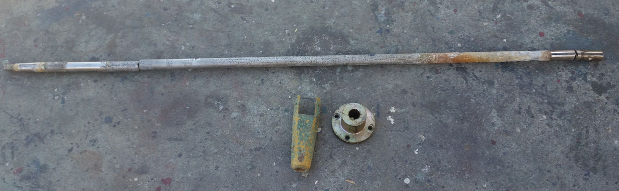

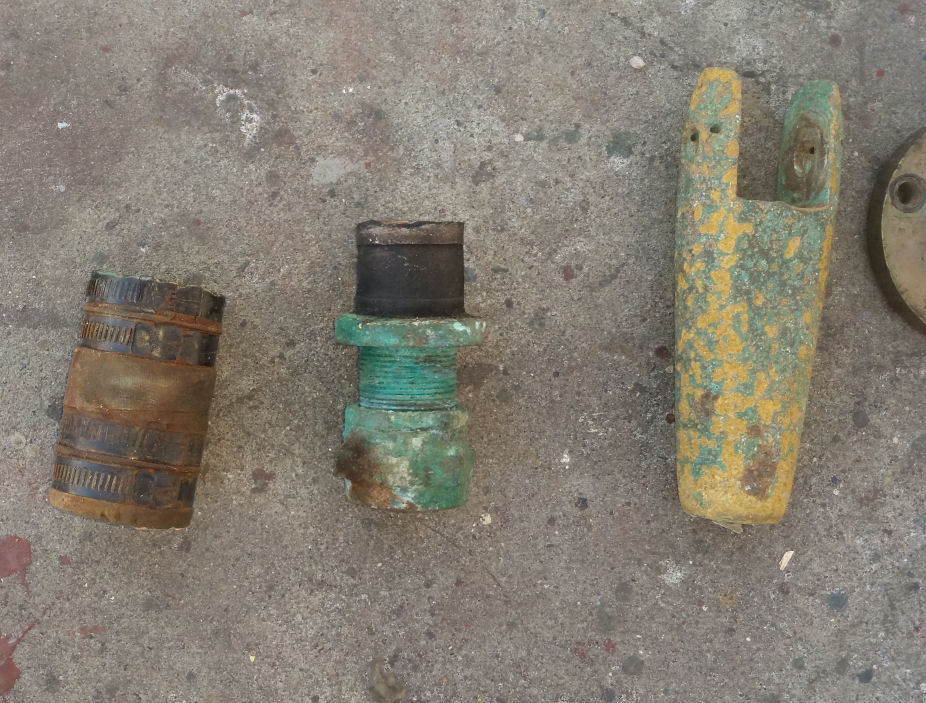

Folding prop replacement project update with photos
I have decided to stay with the 16X10 spec prop that came off the boat. This should be ready late next week from Martec.
Removing the very corroded shaft was easy with a large cutting wheel. The prop shaft came out easy in 3 pieces.
 The coupler is in good shape so that's one less thing to buy.
The packing gland is green and I am going to take it to the wire wheel and loosen the nuts to see if it can be saved.
The cutlass bearing is ordered as well.
I use catalina direct for parts because it has been my experience that they have a great working knowledge of catalinas in general and I know that I will get the right part for my boat the first time around.

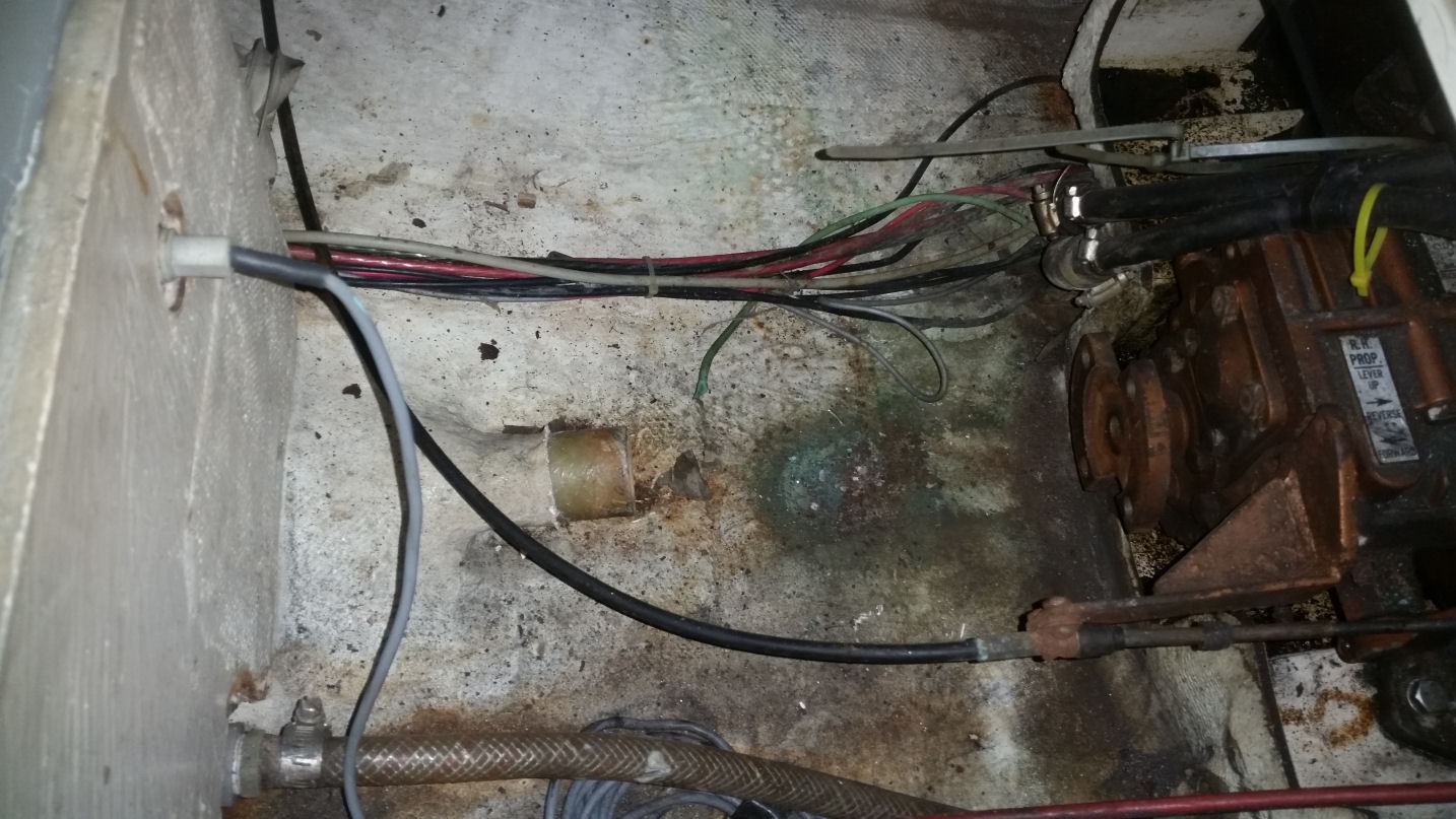

I have sent along photos of the parts removed and the back of the transmission.
One bonus here is that the shaft log is in great shape!
