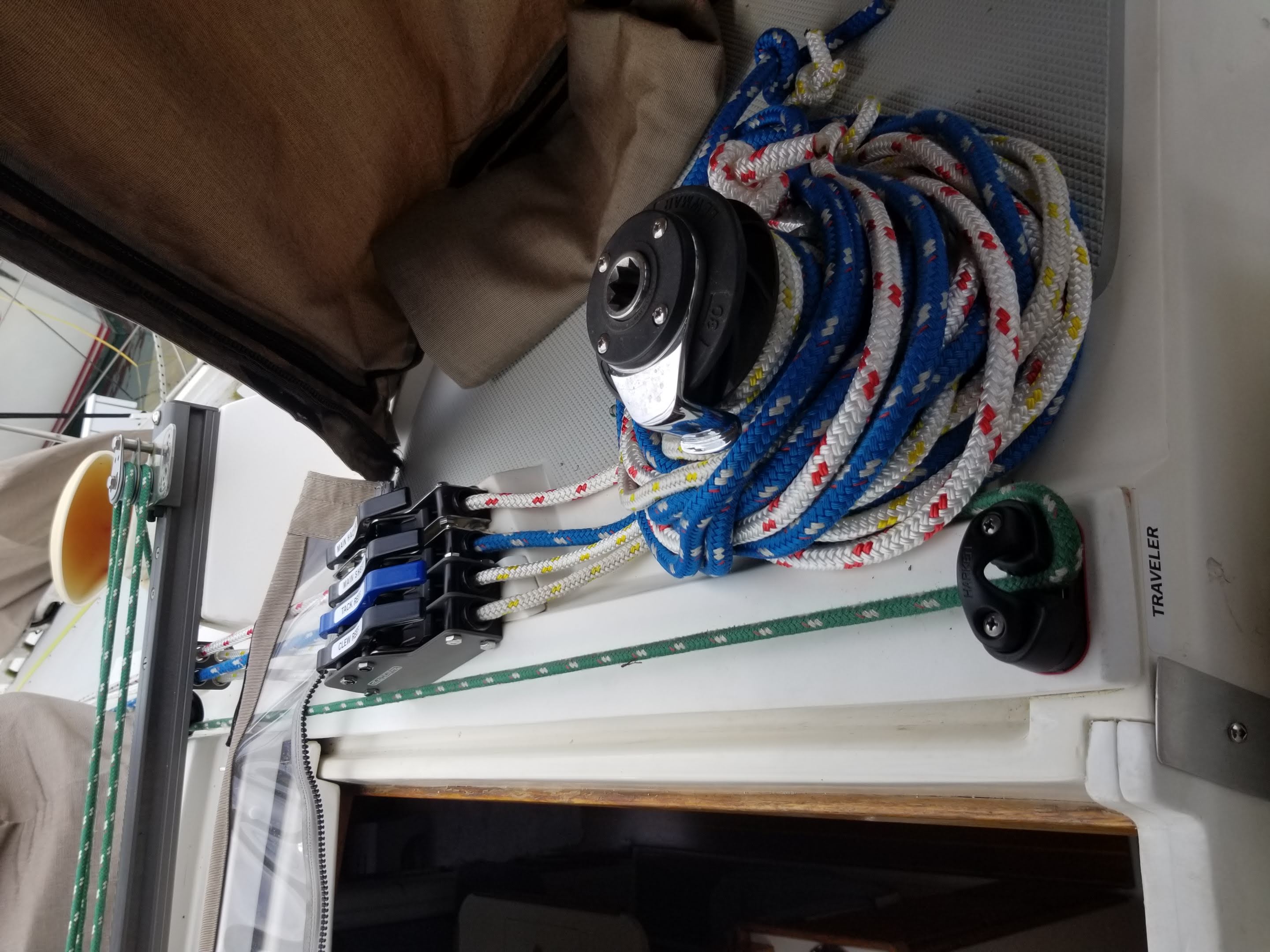

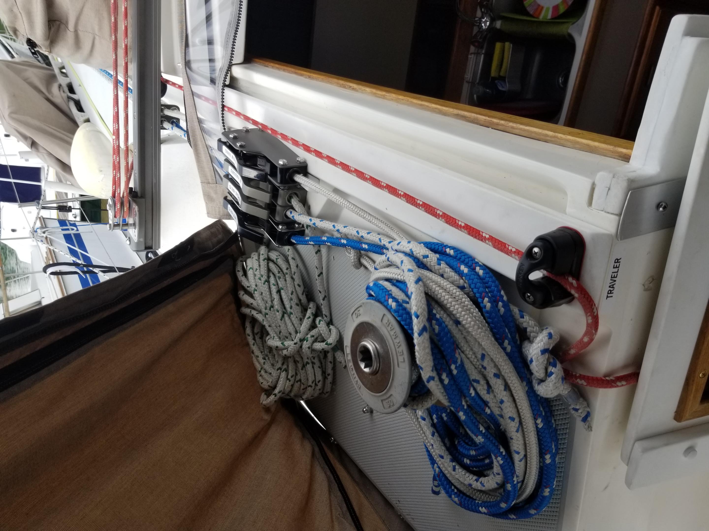

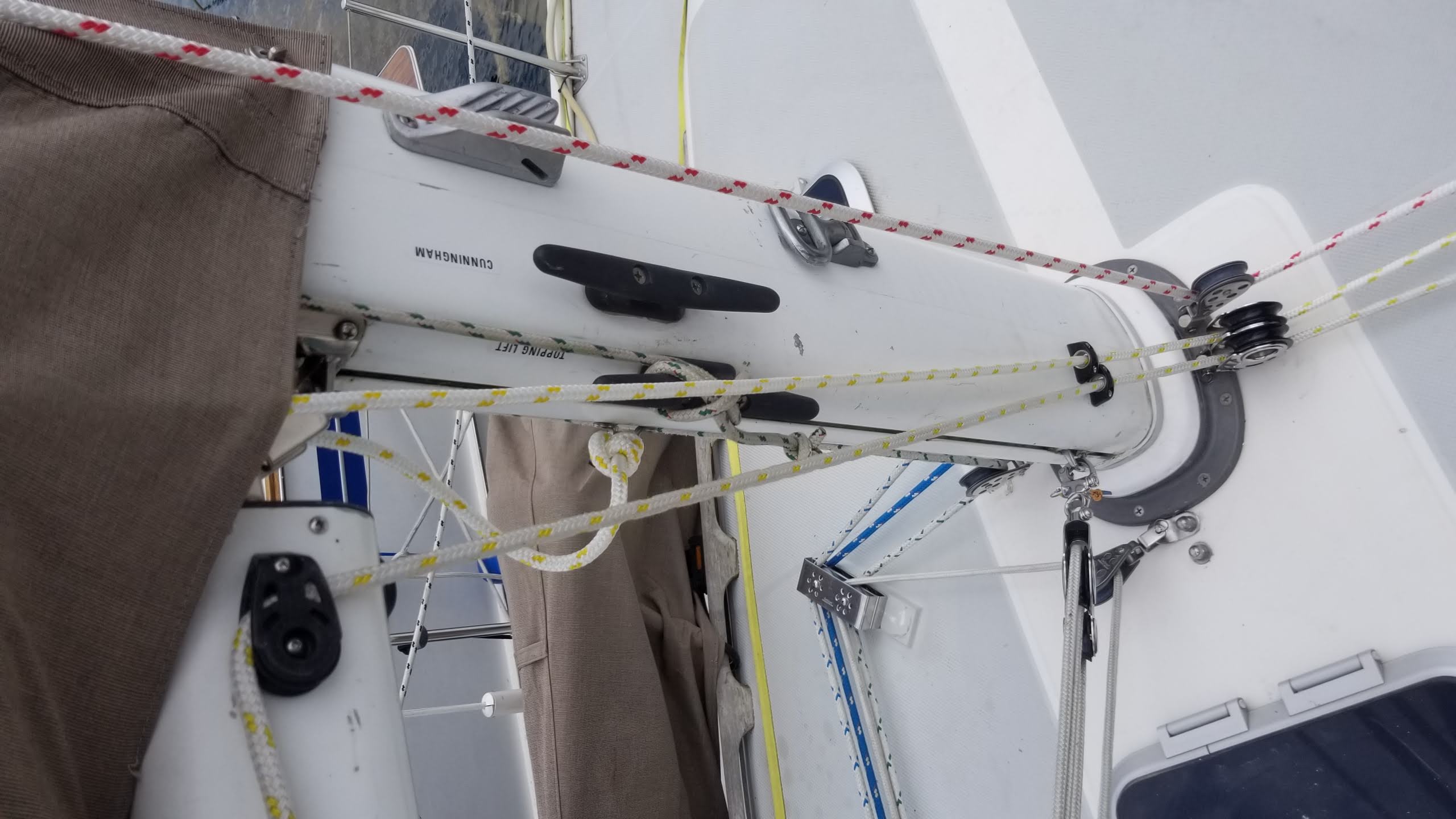

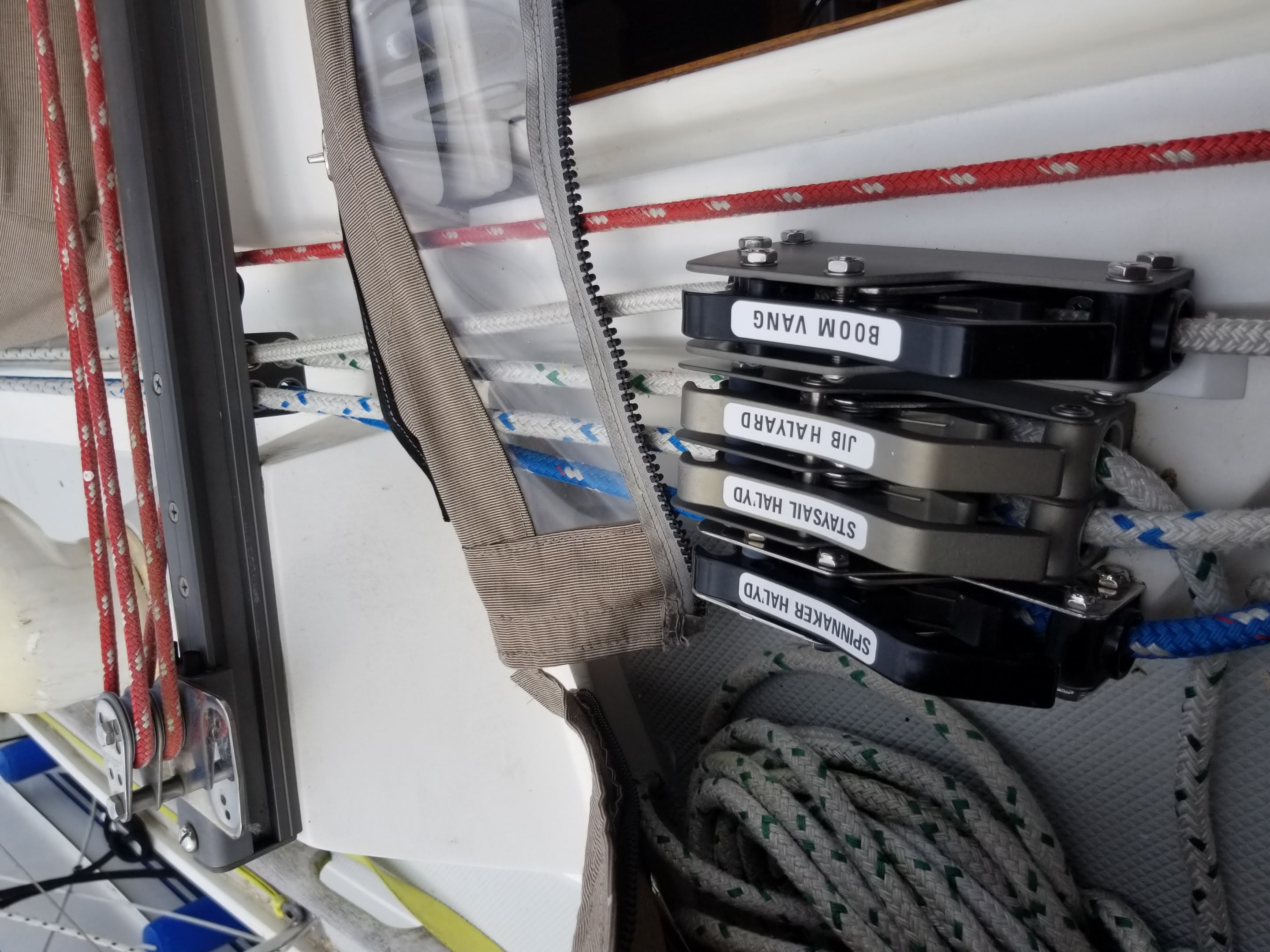

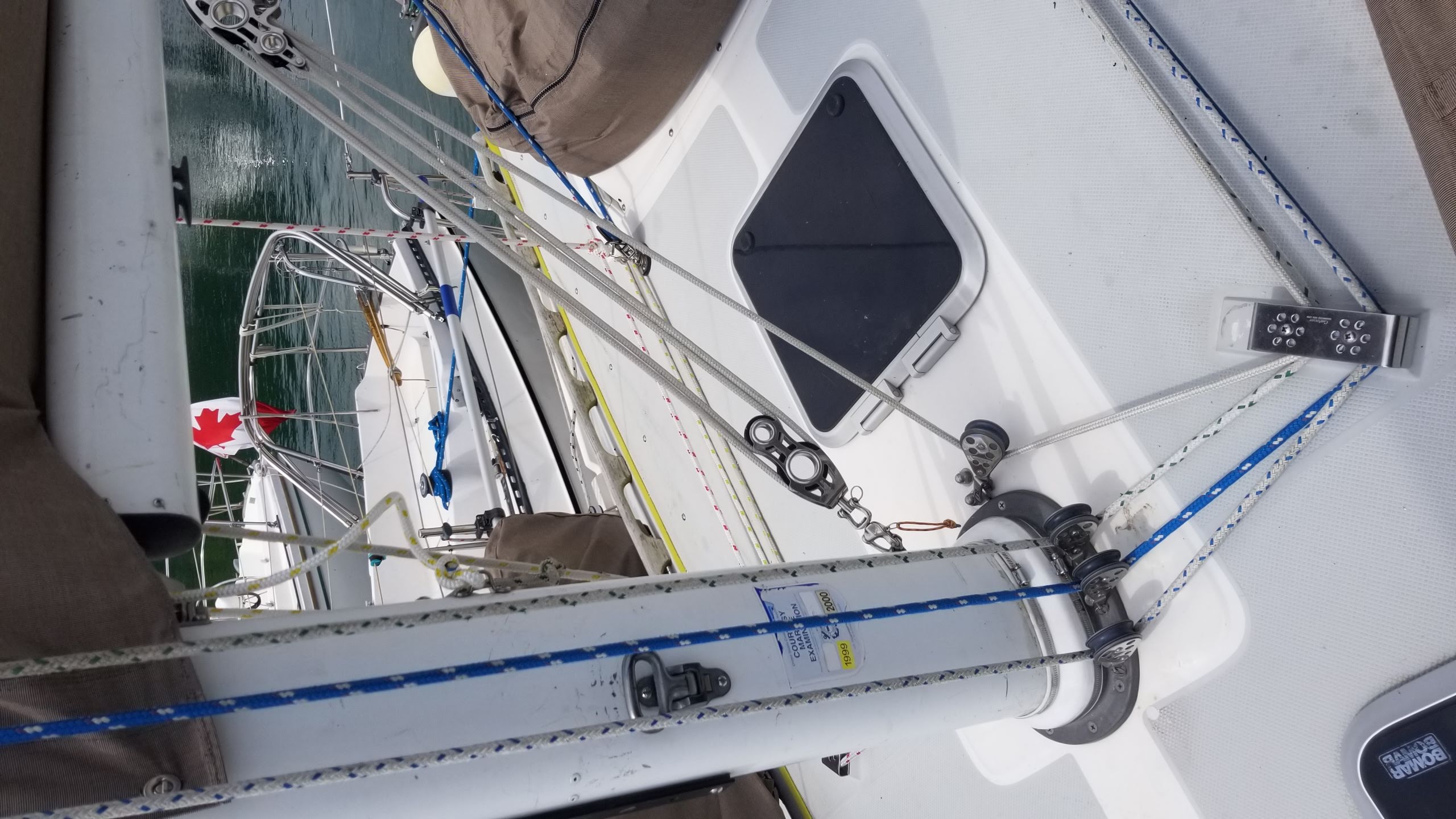

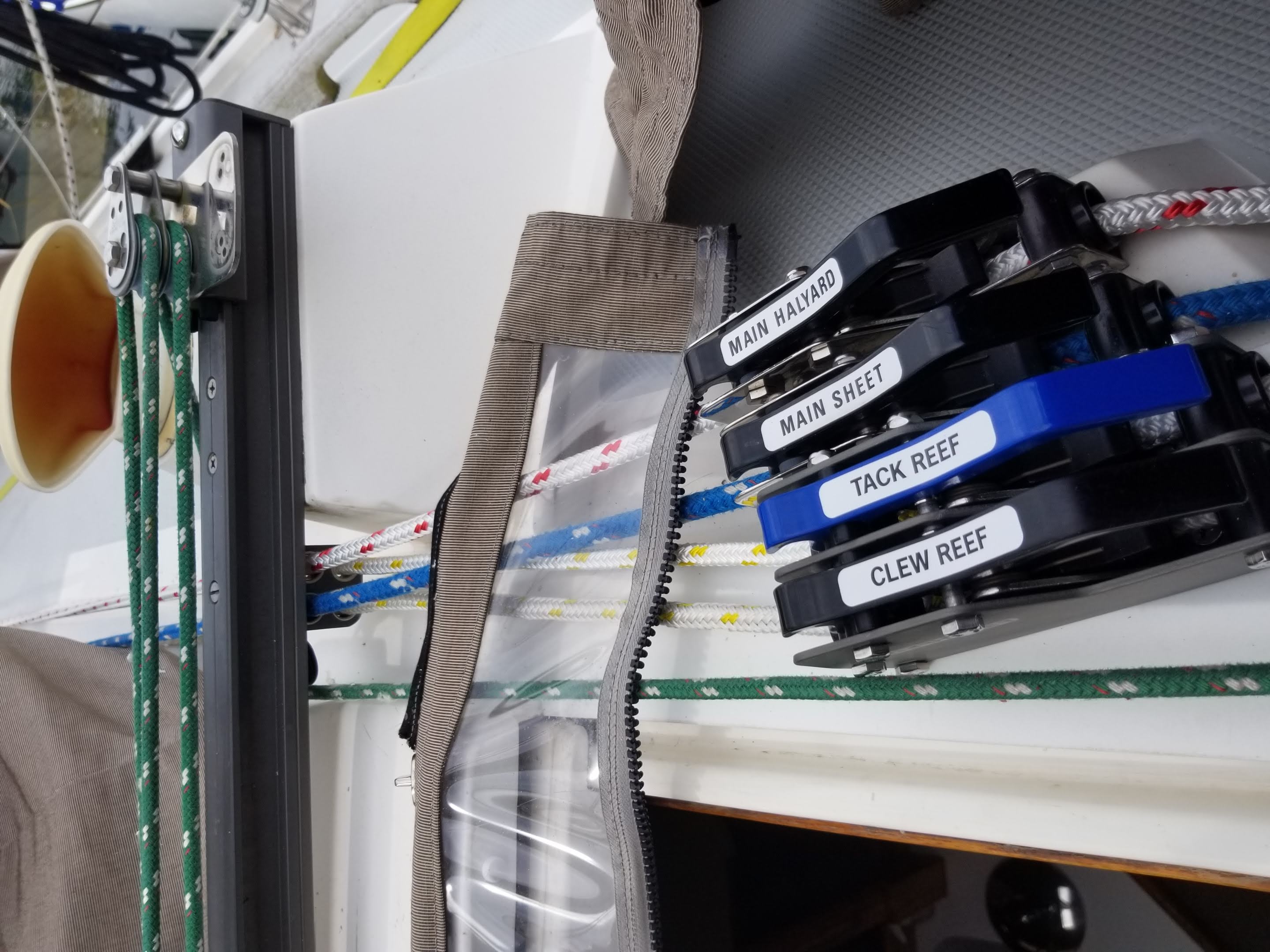

Posts: 257
Like Bill, I'm not clear what you are wanting to do, but I recently re-organized my lines to ensure more control from the cockpit without having to go to the mast (please see photos).  Were you thinking of running the lines on the outside wall of the cabin?  Like over the edge, then along the outside, then back up and over to the winch?  There would be far too much friction if you tried that, I would guess.
Note that the problem many have reported on regarding great difficulty hauling up the main from the cockpit, but not at the mast, was due to binding inside the mast opening for the halyard due to the block at the foot of the mast being too close, angle-wise, to allow for free movement.  Removing the SS fitting and replacing it with a fitting with a block inside eliminated this problem.
