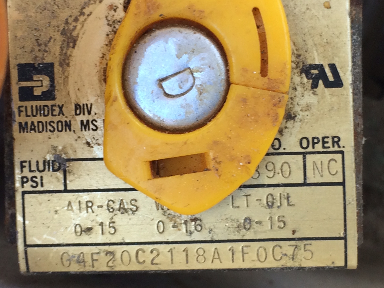

Need to replace the original solenoid installed on Eureka II (1991 hull 1122) I have owned the boat since new so the installation is original.
I am unable to find original or replacement of the original solenoid. Catalina direct does not have, Kent Douglas from Catalina direct has sent me a long list of eventual compatible, but I still lost...can anybody help me?
included picture of actual.

There are two on amazon (search "Marine LPG Solenoid") - which one depends on the size of the inlet and outlet - 1/4 or 3/8"  - to replace you would remove the old one -- screw on the new one - be sure and use gas rated Teflon (either paste or tape) - and connect the electrical the same way it was - probably about 30-40 minute job.
