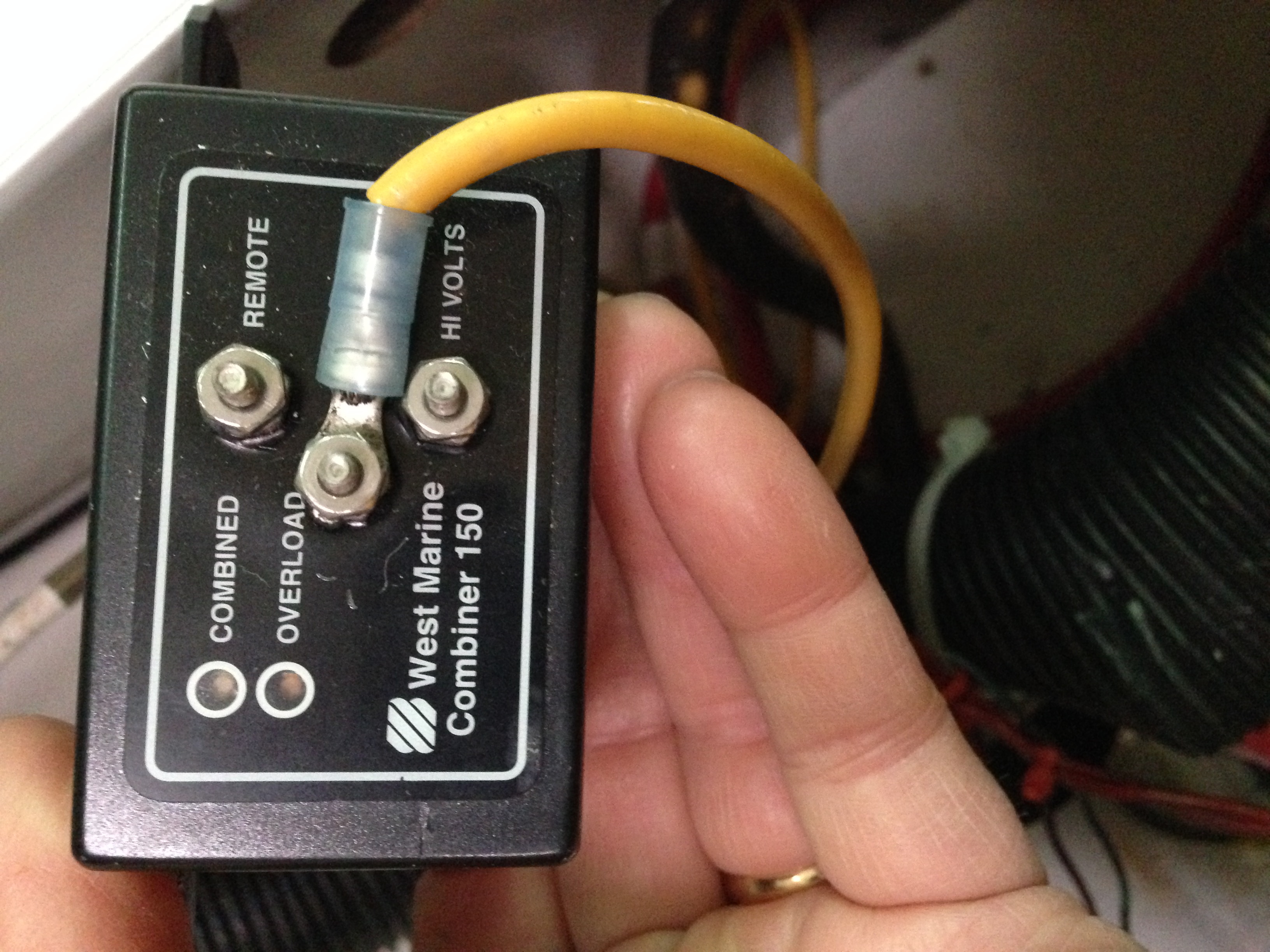

Something to consider might be to add a battery combiner. This keeps the batteries isolated from each other, but when charging is underway, senses voltage and directs the charging current to where it's needed. Google search "Battery Combiner" and you'll get many hits from Amazon, Defender and Westmarine. Installation is fairly straight forward.
As a side note, I had an earlier posting this season asking for help- my combiner was clicking on and off when the batteries were not being charged, and the DC circuit would be intermittently active with the battery switches in the off position. If any are curious about the solution- I found that one of the two house batteries had a bad cell and it was creating a short that drained the battery, and energized the DC circuit. I have two 12V house batteries in parrallel and one starter battery. The combiner maintains starter battery isolation, but provides a charge from the house batteries (when they are being charged).
