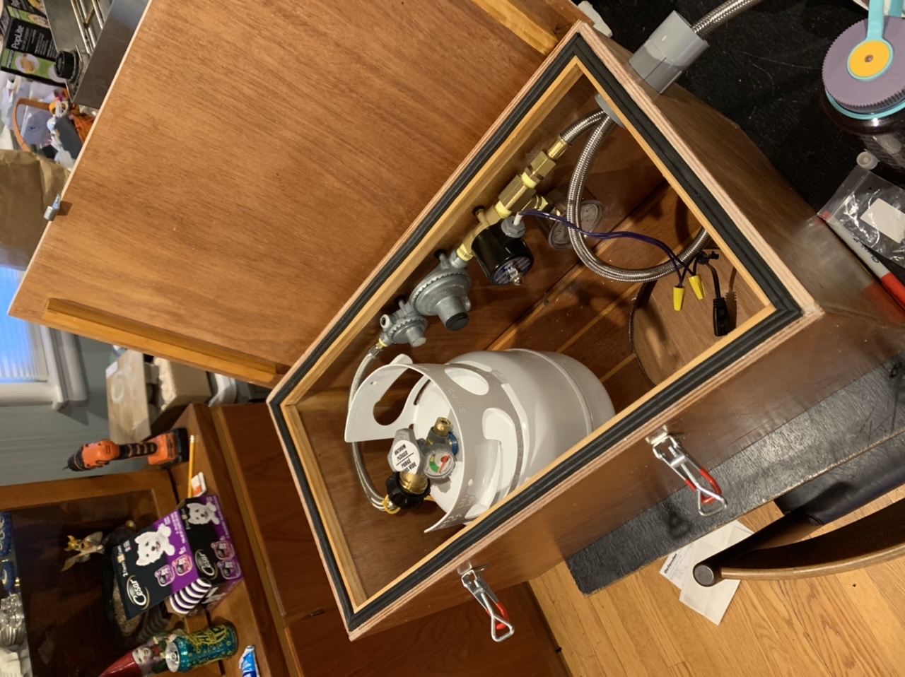

I too am upgrading a 1985 MK1 hull#440 to propane. I chose to build my own locker to fit. I also chose to use 5lb tanks which will likely supply adequate fuel for our weekend trips on the Chesapeake. Definitely vent thru the transom (1/2" ID hose) and definitely replace the supply hose and add sensors tied to the remote solenoid switch. One sensor in the locker and one in the bilge.  I've attached a build picture of the locker and will follow up with pix of the install. I plan to add a 6” round deck inspection hatch to the lid to all easier access to tank valve without unclamping the lid  only time I want to open the locker is to grab tanks for refills.
locker dimensions 21.5 x 12 x 13h
3/8 okume plywood (left over from cabin floor project)
epoxy and silicone to pass the bucket test
drsin under false floor  false floor holds tanks in place

Hi Paul,
It looks nice.  I did notice wire nuts on solenoid leads, when installed they must be crimped and and sealed.
