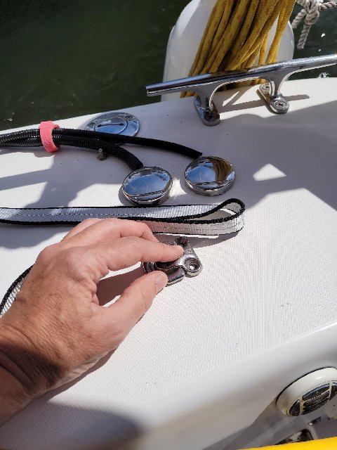

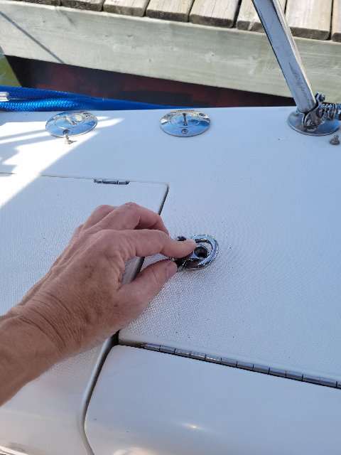

Hi
I am in the process of trying to figure out where exactly I should put the pad-eyes at stern of the boat for my jack lines. They are Wichard Lyf'Safe lines which recommends running the stern through a pad-eye and then back toward the bow for locking with the adjuster.   I am considering placing the pad-eyes in the following locations (pictures attached)
  • Port side - near the propane locker lid above the lazerette lid
  • Starboard side - as far forward as I can reach from the rear locker
Has anybody else installed pad-eyes for jack lines in these positions?  Or perhaps other spots.  I would appreciate any advise and pictures of their installations.

On our boat, I attach the jacklines (which have a loop at each end) onto the stanchion base of the aft pulpit.
