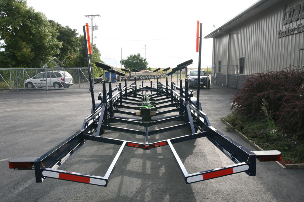

Hi, everyone.
I'm thinking about purchasing a custom trailer for my C36 MK1. Looks similar to the one in the attached picture. This is the company that makes them:
[url]http://www.loadmastertrailerco.com/[/url]
Does anyone have experience with this company?

Ben,
If you joined us recently I hope you received the Tech Notes CD. In that CD are the manuals for the MKI & MKII boats. The specs in Section 5 show and overall height from the keel to the top of the cabin as 13feet 6 inches for the standard keel. You then need to factor in the height off the trailer, I would assume you would be under 15 feet. You would not go unnoticed and I would not recommend towing it with your Volvo unless it were of the fifth wheel variety.
hilbre
Joined: 7/19/08
Posts: 218
Ben:
Just a reminder, as it is considered an oversize load, you will need to check the regulations for each state or city you travel through as these vary considerably.

Good point. I was planning to have a professional company do the hauling.
